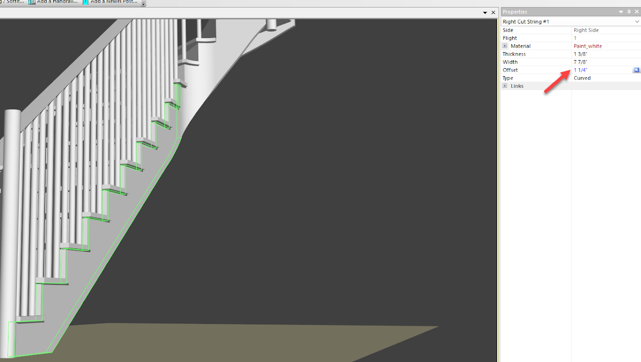

First add a recess to your Cut String (and handrail) equal to your nosing (here 1″ 1/4):
fix_1-1.pngImage Enlarger

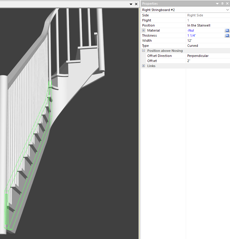

Add Stringboard with the same thickness as “nil material” (or 100% transparency):
fix_2-1.pngImage Enlarger

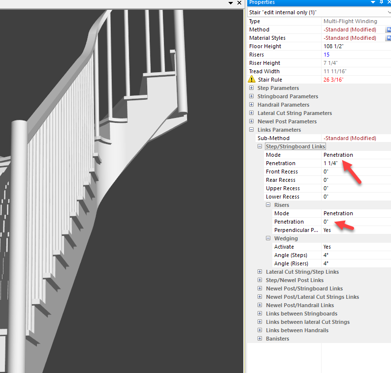

This will then allow you to modify the step penetration and risers into stringboard to obtain the desired view:
fix_3-1.pngImage Enlarger
