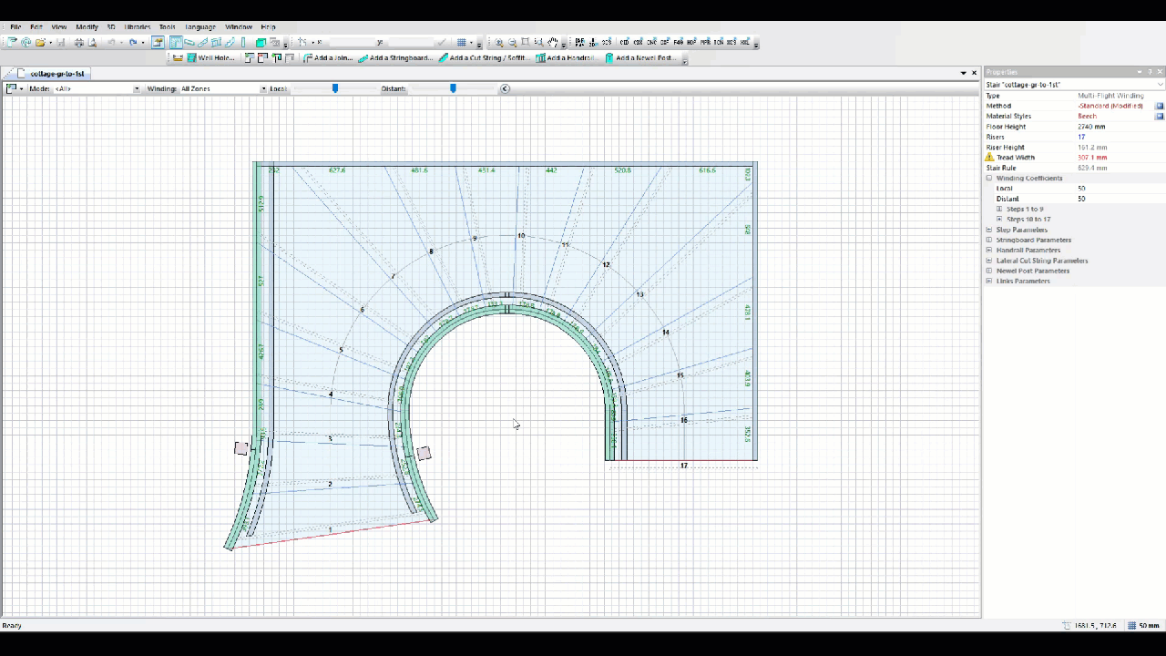

You can double-click on shape outline and then move the points as required,
Stairedit.gifImage Enlarger

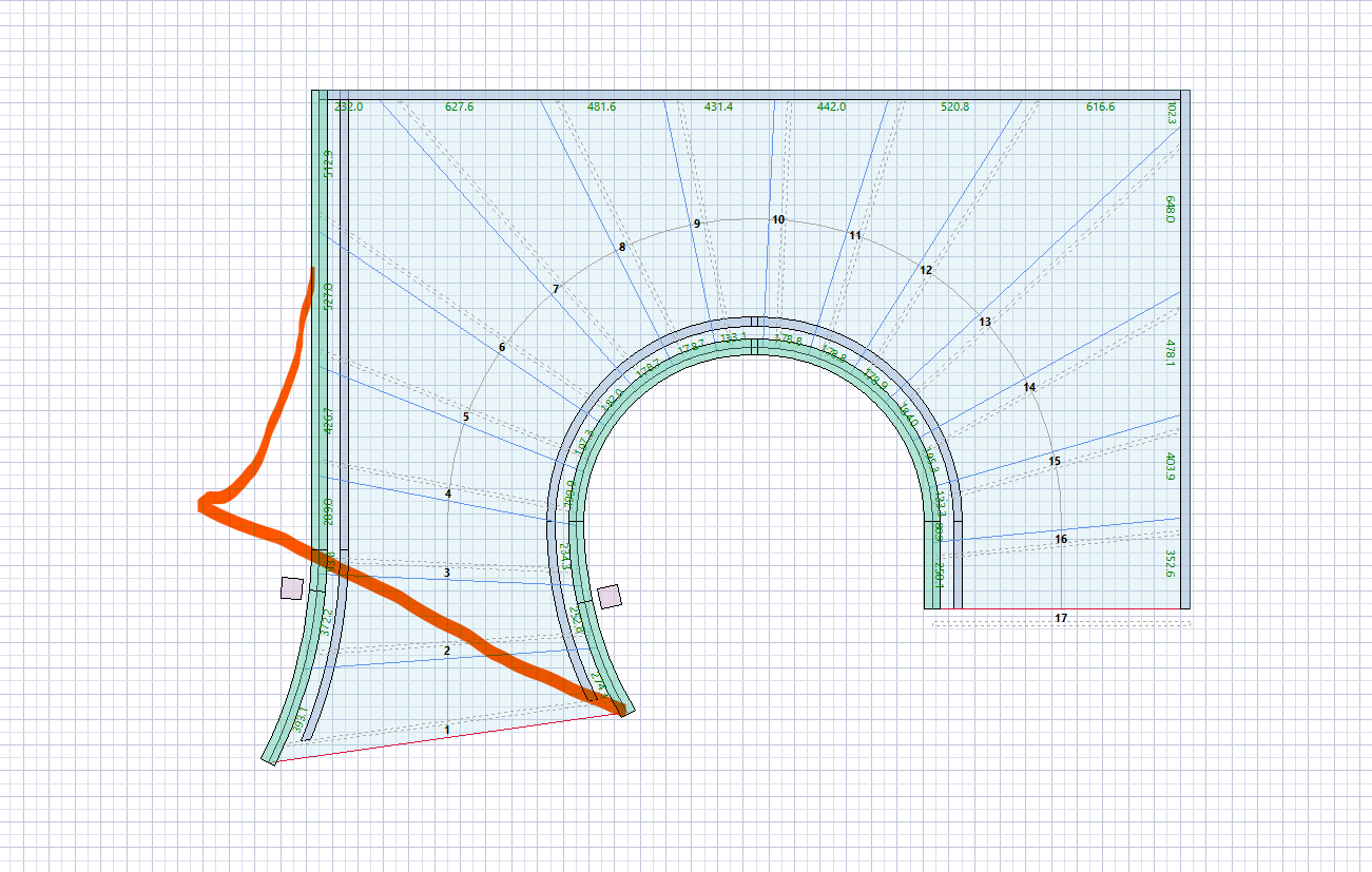

June 30, 2025 - 9:12 am
Hello how I can change the shape of the staircase itself? Attaching picture roughly shape I need to make it. Thank you Screenshot-2025-06-30-090142.pngImage Enlarger
