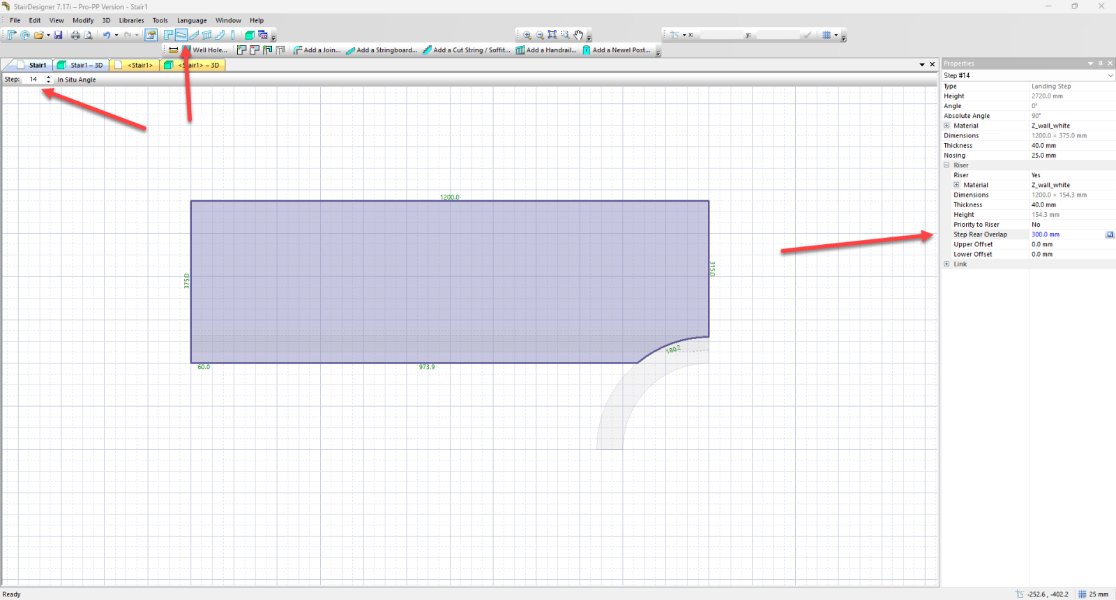

Hi Alex,
The only way to add the joint is by removing the landing step.
You can remove the landing step, add the joint, and then edit step 14 to align with your plan. Check the attached image—try manually adjusting the shape of stair 14 to see if it achieves your goal.
Let me know if you need further assistance.
Best,
Landing-step.pngImage Enlarger

Forum Posts: 1173
February 14, 2025 - 12:35 pm
Hi Alex,
Best,

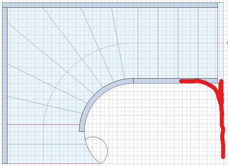

Hi Team,
When a staircase is drawn with a landing step i can no longer add a join onto the right strinboard where it meets the landing. Please can you show me if this is possible. I have attached a jpeg of what i want to do and the Stairdesigner file.
Alexdesign-stair.jpgImage Enlarger
