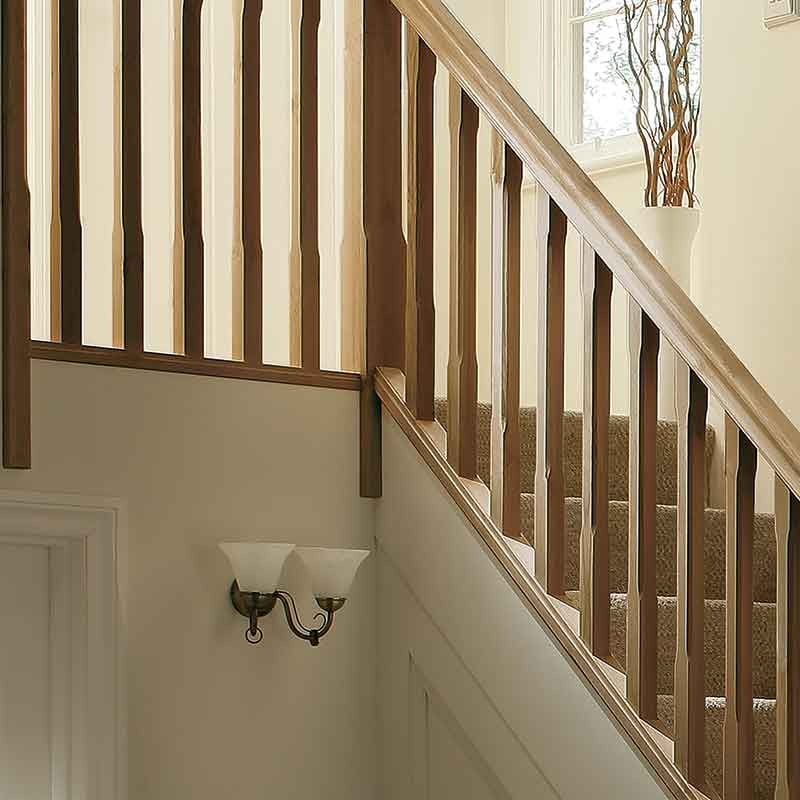

September 19, 2025 - 8:23 am
At the moment, this isn’t possible directly within StairDesigner.
My recommendation would be to incorporate this into the height of your string board. You could then cut and manufacture it separately using your CAM software.
I understand this isn’t the most ideal workflow, but I believe it’s the best available solution when working with StairDesigner.
I’ll continue to think about alternative approaches, and if I come up with a better solution within the software, I’ll let you know.

September 18, 2025 - 4:07 pm
Apologies, hope it has worked now.stair-with-base-rail.jpgImage Enlarger
base-rail-on-stairs.jpgImage Enlarger

September 18, 2025 - 12:53 pm
Please see attached.

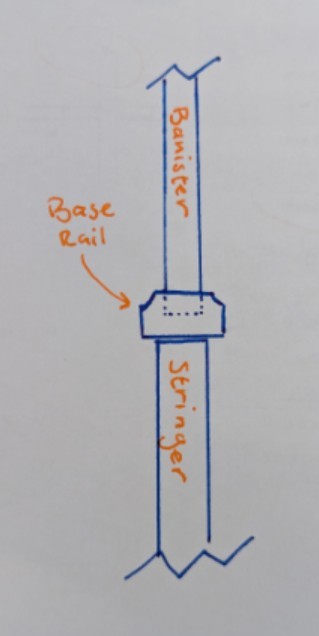

Forum Posts: 1663
September 18, 2025 - 12:10 pm
Can you please send me an image of what you are trying to achieve? I will then show you what is possible with StairDesigner.
Joinery Department
Forum Posts: 19
August 13, 2025
September 18, 2025 - 11:53 am
Good morning,
Would someone be able to advise on how to add a base rail on the top of a (straight) stringer)
My current project has 32mm stringers, with 41mm banisters. These banisters should connect to a base rail, which sits on top of the stringer.
Image attached)
Thank you,
Peter
