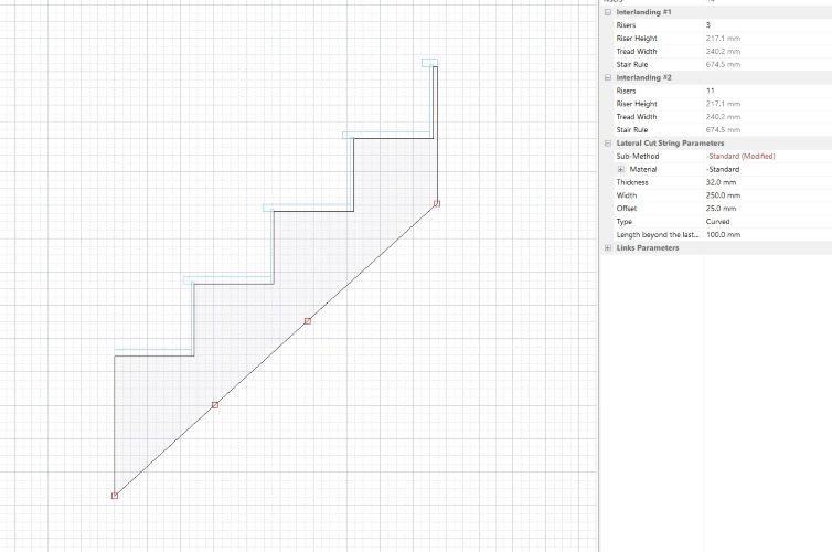

I was trying to move corners.  Still, I probably would have seen it if I looked with my eyes.  Cheers Isaac.

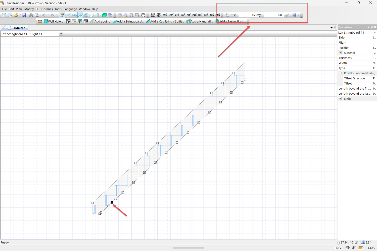

Hello Tom,
Thank you for your question, and I apologise for the delayed reply.
See the following image. You can adjust the points for your components through grid referencing. You can adjust them through specific points rather then manually dragging them into a position.
Note: The external corners may be locked in this view.
2026-06-15_14-40-06.PNGImage Enlarger

June 12, 2026 - 1:29 pm
Is there an easy way to locate an anchor point rather than dragging it into place.  For example, on the string attached I want to put the bottom left anchor at (0, 429.3)Example-of-stair-string.jpgImage Enlarger
