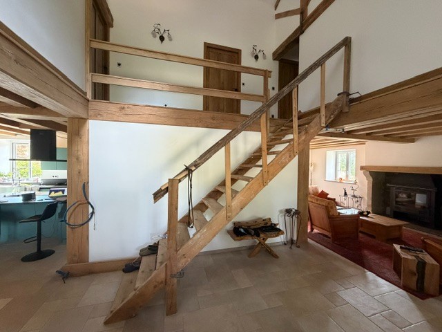

Good morning Isaac,
Could I have the stair file please.
Thank you again fir your help.
AS ever,
Colin

Hello Colin,
Thank you for this.
In StairDesingner, we can only drawer risers as straight for the moment. This would need to be completed manually in manufacturing.

Thank you for your help the veido was very helpful.
The photo was just to show positioning for new stair and give some context.
Step one riser, I am trying to curve the riser under the end of the step if that makes sense!
as ever, Colin

Hello Colin,
Can you please specify your concern regarding the riser on step 1?

Good afternoon all sorry, if I am reposting! think I might have made an error on Monday.
could you have a look at my file please any comment’s would be appreciated.
stair rule is just outside recommended limits?
Step one is showing red and I having trouble sorting the riser?
is there a better option for Newel post #2.
Thank you in advance (Perhaps I should stay with pen and paper at my mature age)😂
ColinIMG_3429-1.jpegImage Enlarger
