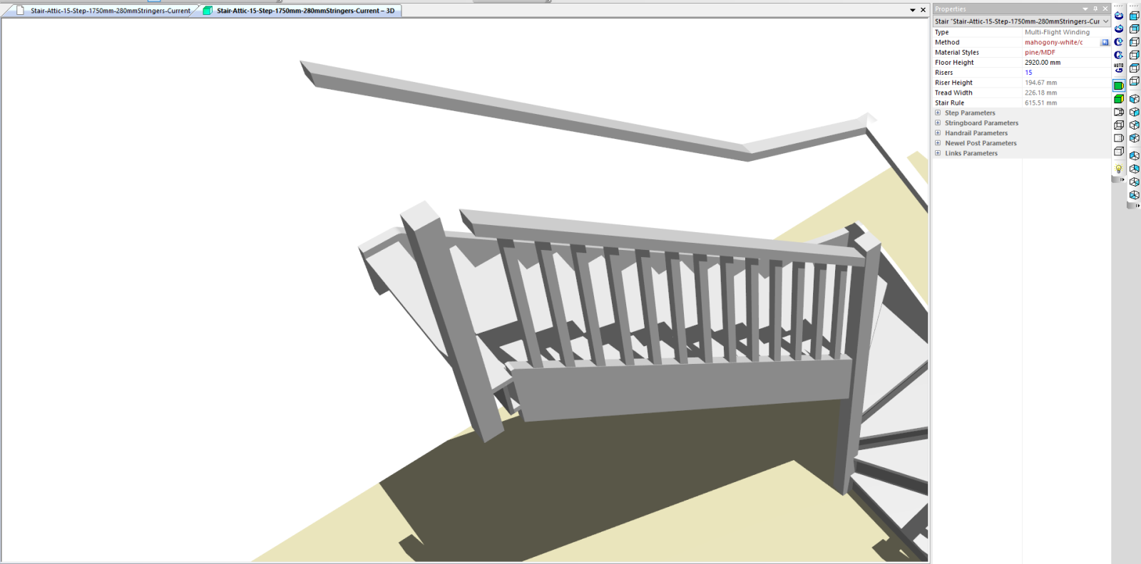

Gerard McDonagh
Forum Posts: 3
January 29, 2026
February 23, 2026 - 1:41 pm
            Didn’t know how to do that, so now can thanks. Was also looking to add Newel post at top of stairs on Left Stringer but this is what happens. I can extend stringer for joint on timber part anyway unless easy way to add? Thanks.
Ger.Top-Newel.pngImage Enlarger

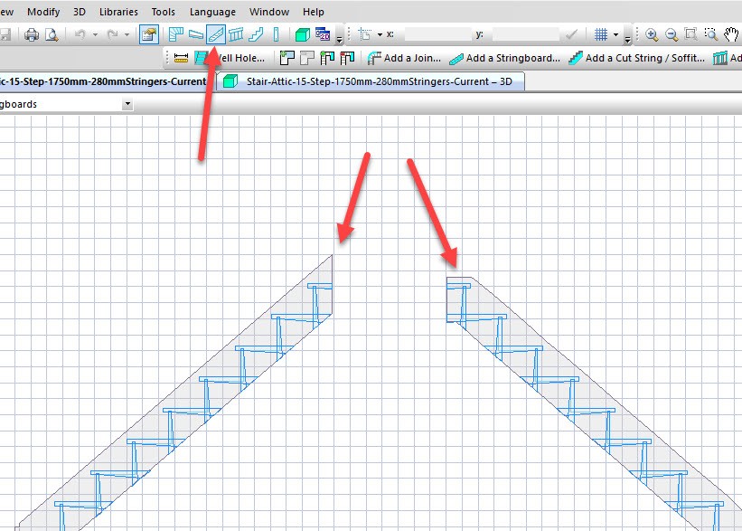

Forum Posts: 1583
February 23, 2026 - 12:45 pm
Hello Gerard,
From what I can see and understand, the design seems sound to me.
Note the different stringboard shapes at the top of the design. If you need to modify these or create notches/hooks, you can do that through displaying the stringboards:
image.jpgImage Enlarger

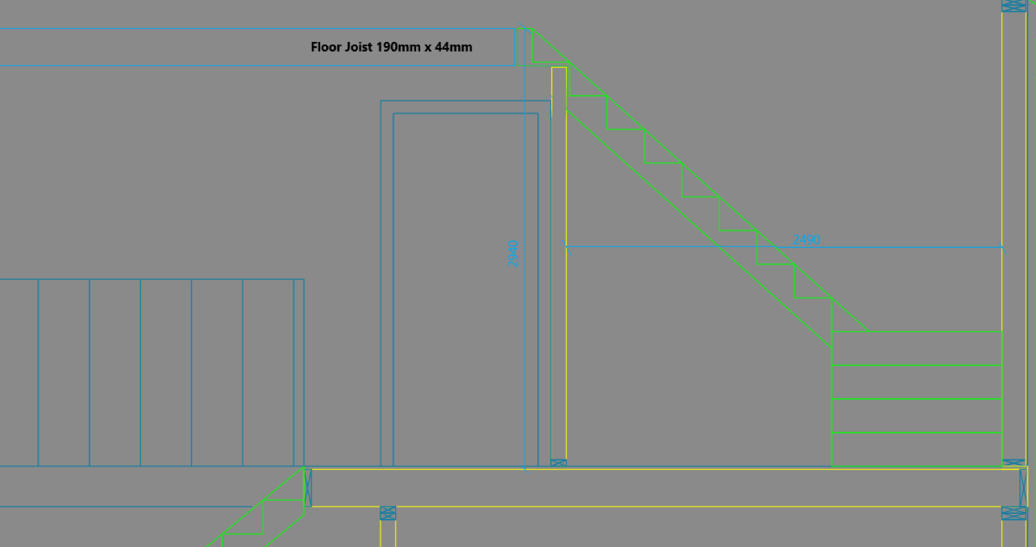

Gerard McDonagh
Forum Posts: 3
January 29, 2026
February 23, 2026 - 12:02 pm
   Can you please have a look at attached design and let me know if it is ok. The stair well is limited and roof is 35° above it. I am thinking of aligning step 14 with the top of the wall and notching stringers to suit. Hope this makes sense with images…
Kind Regards,
                   Ger.Attic-Stairwell-Size.pngImage Enlarger
