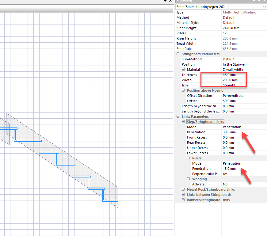

Forum Posts: 2128
May 19, 2026 - 5:41 am
Can you please check again, I see 296 mm width, and a value of 30mm from Step to stringboard. ( did you have 15 like riser in mind?)

Chas Joy
Forum Posts: 7
April 28, 2026
May 19, 2026 - 5:33 am
Hi!
Appreciate the reply.  Ok got it! I have now ammended the dimensions and increased the stringer width to 396 mm  to accommodate the steps. I think if there are no apparent issues then we can go ahead and generate the files!

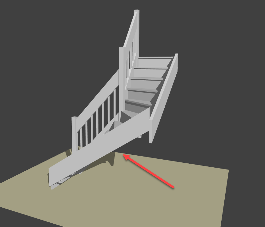

Chas Joy
Forum Posts: 7
April 28, 2026
May 11, 2026 - 7:22 am
Thank you for your reply and question!
I did not see anything in building code that would impact the usability of such a design. What do you think. Would this sort of design in particular where the stringers meet pose any safety risk? Based on your experience of relevant building requirements. I do not expect you to read up on building codes in Norway, but I would expect a certain level of consistency throughout Europe. Furthermore the stairs are only to connect two floors and i shouldnt expect them to be in use at all. The whole purpose is to be able to rent  out the lower floor. Let me know what you think! It is tempting to keep things as simple as possible hence the straight stringers!

Forum Posts: 1441
sp_UserOnlineSmall Online
May 8, 2026 - 9:05 am
Hello Chas,
Yes, I will provide you with your Stair Files.
Before I do, can you please confirm that you are happy with your lower stringer detail?
