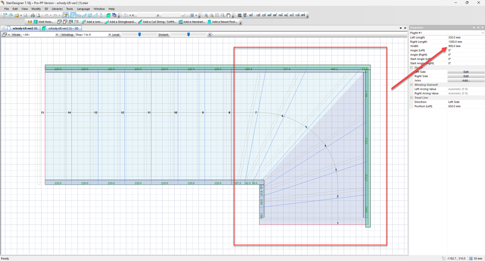

May 29, 2026 - 12:39 pm
Thanks, I can do these now. Can I please confirm, the first flight is set to 900mm wide. Is this correct?

May 29, 2026 - 10:06 am
I am very sorry for the inconvenience, I am now uploading the corrected file with the correct data, thank you for the explanation
May 29, 2026 - 9:55 am
Hello Łukasz,
With your subscription, I am only able to provide one set of files per month. Please make sure all details are correct before submission.
This time, I will provide you with a replacement for the first set of files. Can you please edit your model with the required changes, and then upload your updated file. I will then provide you with your new files.

May 29, 2026 - 9:40 am
Thank you very much. Unfortunately, I made a mistake in the width. Instead of 950, it should have been 970. Could you please send me the corrected file again?
