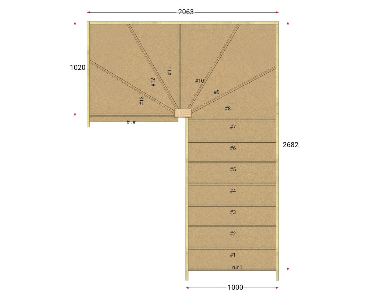

hi isaac. will strings still be in middle of posts?
August 6, 2025 - 12:31 pm
Hello Sean,
Yes, delete the newels and add them back in. Then you can adjust their position to suit your requirements.

August 6, 2025 - 12:23 pm
hi Isaac.
the second design is closest but could posts go tight together?
August 6, 2025 - 11:15 am
Hello Sean,
See two examples attached.
One is using the winding stair. This is as close as you will get on stair designer with winding stairs.
The other option is closer, using landings to create your steps.
Let me know if you have any questions.

August 5, 2025 - 4:00 pm
hi aaron thanks for quick responce.the stair you have sent back still has 7number winding steps is it possible only to have 6 as shown in file below?
thanks seanwinder-stair-1.jpgImage Enlarger
August 5, 2025 - 3:11 pm
Hello Sean,
Please see these modifications and tell me what still needs updating? If these are a lot closer, I can show you how I made the modifications.
Please note, the 4th step cannot be straight on Aarons stair with the required lengths. You would need to make this staircase longer.

August 5, 2025 - 1:23 pm
ihi all i actually have another winder stair coming up and have the same problem i will also send files i have not started this  yet.
FTF is 2645mm.aarons-winder.jpgImage Enlarger

August 5, 2025 - 1:18 pm
hi all
i recently made a stair for a client i will send files.the image i sent was a 6 step winder  but could not seem to manage to draw on your software. i have fitted stair but wanted to know if stair could be drew like image i will send both files .hope to hear from you soon.
thanks sean.winder-stair.jpgImage Enlarger
