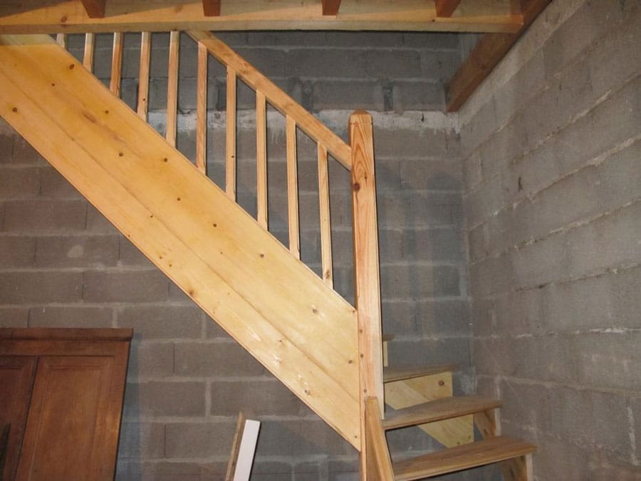

To start, I’d like to thank you for all the help and advice you have given on your site. 6 months ago I went to a well known stair manufacturer in France to order a cheap staircase to enable me to access the first floor of my garage.
The stair was a ¼ turn, with a total height of 3,28 m, at a 95°.
After a long time spent trying to force his industrial software to build a stair that would fit, the salesman could only offer a 15 step quarter turn with a 90 angle.
This was no good to me at all. So I decided to build it myself.
I’m not a professional woodworker, in fact I’m a scientist, but I’ve always liked woodwork. Browsing the web for help and information I quickly found your StairDesigner software which gave me the answers to my questions.
With help of your documentation and tutorials, I quickly and easily got the hang of using the free version of Stair Designer, and designed a stair to fit my project.
Nonetheless, having at my disposal the plans of the parts, steps, stringers, posts and spindles, but without dimensions, I found myself with a choice to make: not being a professional I did not want to buy the full version of the software.
I thought of buying your highly-rated plans (through your StairFile service), or to accept the challenge and reconstruct the plans from the specifications given by the demo version of Stair Designer.
I opted to take up the challenge and draw the plans myself. I revised my trigonometry and rolled up my sleeves to learn to use the free version of ProgeCad. I managed to draw the plans and use ProgeCad to get all the part sizes.

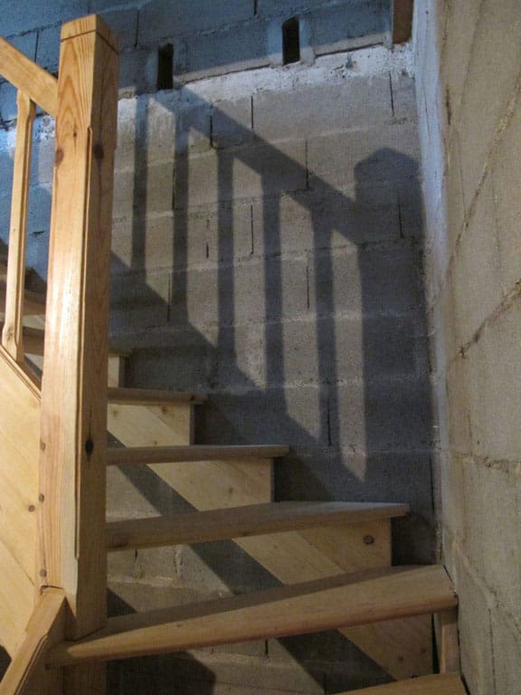

I chose to make the stairs in spruce, using only the minimal tools that I had at hand, a jointer, circular saw, a router and an orbital sander. I worked part time at my own pace, for 2 months (I’m retired so I do have some free time) and machined up the parts.
Yesterday I did the install and everything fell into place perfectly, just like the drawing.
