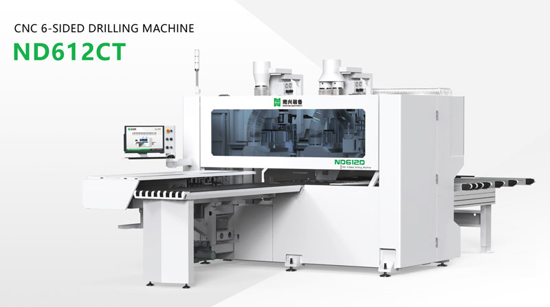

A Drilling machine from Nanxing
Nanxing 6-sided CNC drilling machine
PolyBoard can integrate with virtually all these machines, allowing you to take a cabinet or furniture piece from your parametric design through to manufacturing, including cutting, drilling, nesting, and machining.

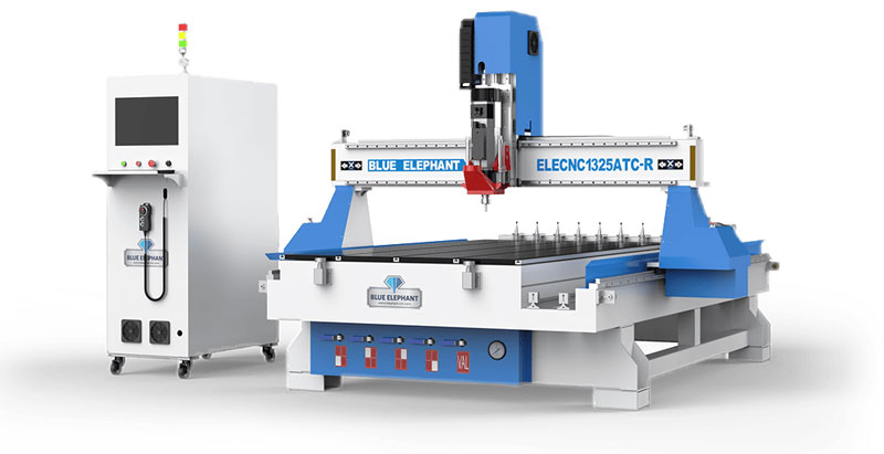

Nesting CNC machine from Blue Elephant
Blue Elephant nesting CNC machine
This allows for the information created from PolyBoard, such as drillings, grooving, and other machining operations, to be transferred to a machine’s software for nesting and production.
PolyBoard can also export to a range of other file formats, allowing alternative workflows where the machine’s nesting software supports compatible formats.

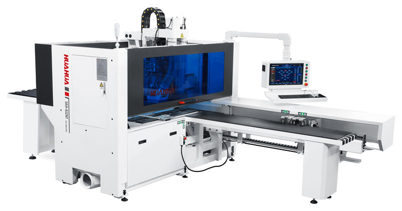

Drilling CNC machine by HUAHUA
HUAHUA 6-sided drilling CNC machine
Many of the machines in this category use .mpr files and can automatically identify the machining program using a barcode or QR label.
PolyBoard generates the machining information for each component, including the relevant barcode/QR reference, allowing the production workflow to run from the original furniture design through to automated drilling.
The exact file format and barcode workflow depends on the machine and its controller. PolyBoard also supports a range of other file formats for compatible CNC equipment.

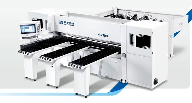

Beam saw
Beam saw by SYUTECH, compatible with PolyBoard and OptiCut
For beam saws, you can use two workflows:
PolyBoard → beam saw software
PolyBoard can export components and cutting information in .txt or .csv format for import into compatible optimization and beam saw software.
PolyBoard → OptiCut → beam saw
Alternatively, PolyBoard can send the cutting list to OptiCut, which optimizes the panels and generates the machine-specific output required by compatible beam saws.
