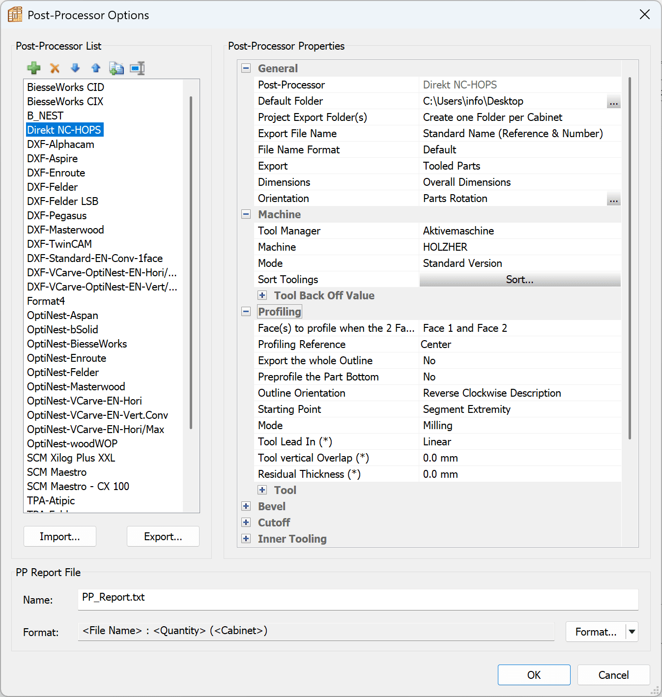

Once you’ve completed your design, use PolyBoard’s NC-HOPS post processor to output the .hop files. The post processor includes all the customisation of parameters you need to configure the output to your production methods.
This makes it extremely quick and accurate for NC-HOPS to generate the machine. In fact, it’s practically automatic.
Polyboard's NC-HOPS post processor
PolyBoard’s Direkt NC-HOPS post processor
StairDesigner is similar, but you would utilise instead the DXF post processor and load part by part 2D DXF files into NC-HOPS. This post processor also comes with a suite of configurable parameters to mirror your way of working.
