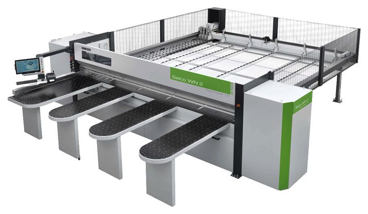

There are a large range of Biesse Selco saw models but the interface they use can be split into 3 generations as follows:

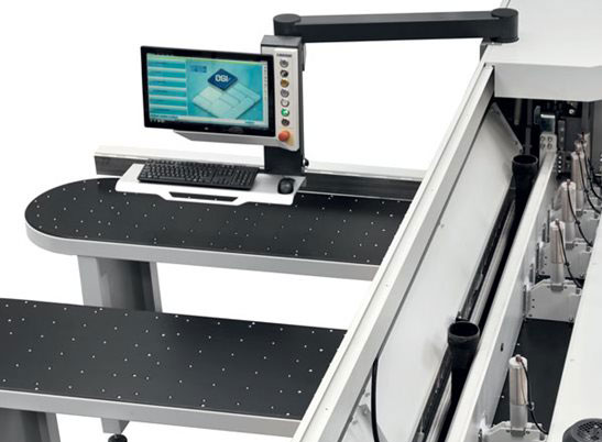

1. XML interface (OSI interface)
All recent Selco saws are supplied with the XML Link interface. If this is the case OptiCut’s XML post processor will output the optimised cutting map files to run the saw.

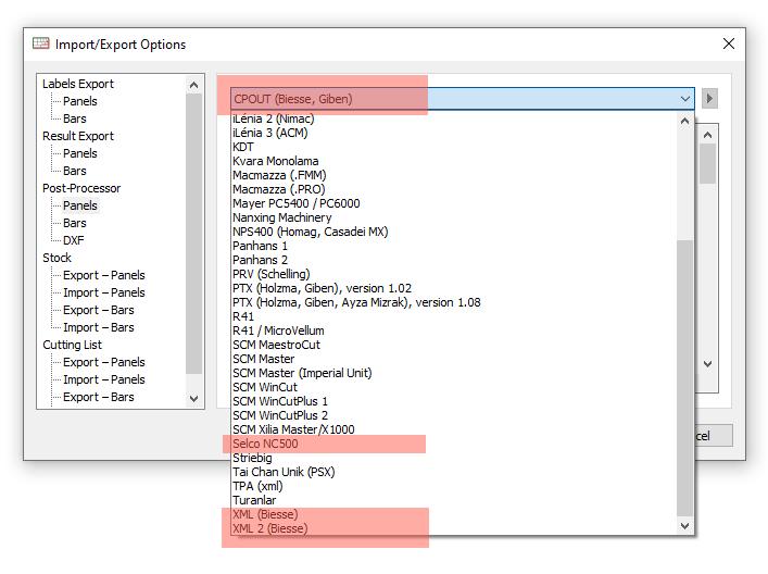

OptiCut’s post processor configurations
This screen shot of OptiCut’s post processor settings shows all of the different options:
