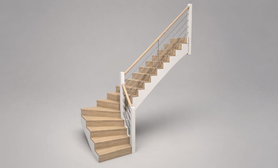

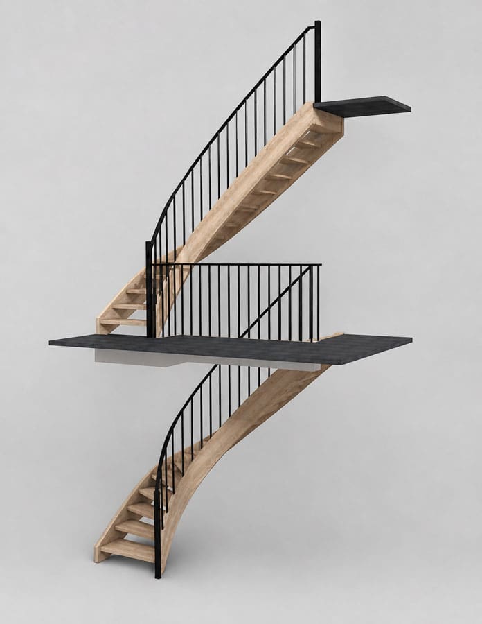

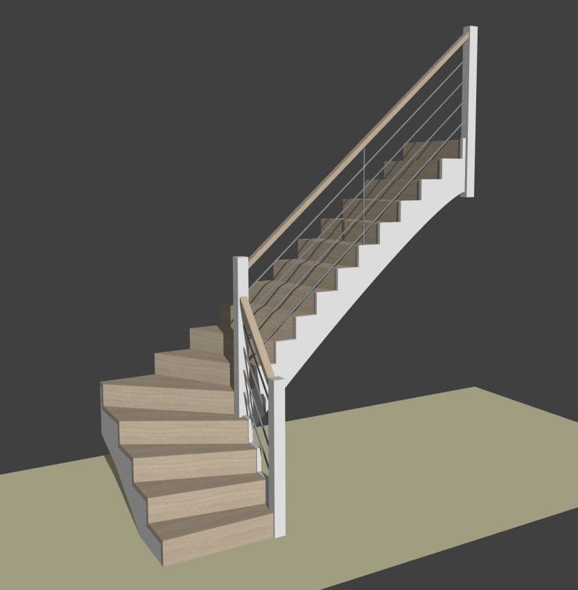

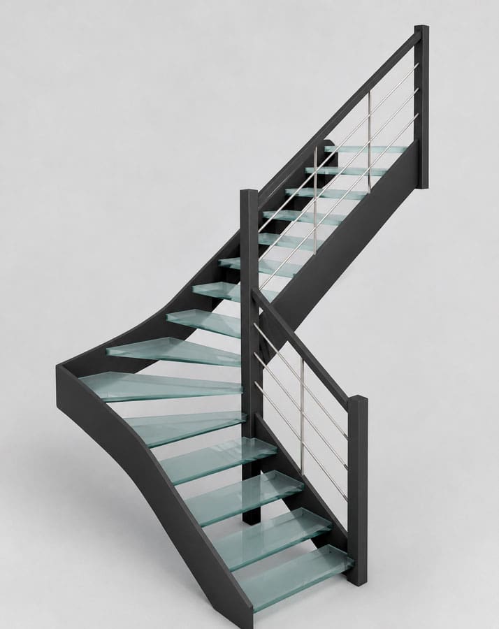

And here are two stairs rendered from StairDesigner models, click to enlarge:

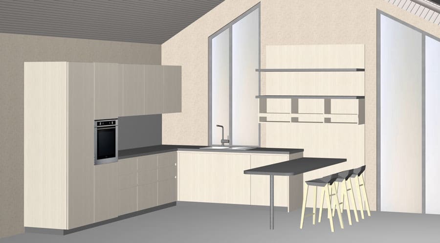

Prepare your PolyBoard or StairDesigner projects
Before you create a render, it is important that you start with a well organised and clean PolyBoard or StairDesigner model. Remove any elements that are not necessary to the final visual of your project including construction aids and placement references.
Make sure that you have applied accurate material textures to your project as this will guide the AI and allow it to improve the realism of your project.
Once you’ve completed your project, take a high quality screenshot that clearly displays the total design. Use Windows built in Snipping tool or a free or paid application with these points in mind:
  • Choose an angle that best showcases the project
  • Ensure the image is clearly lit, and avoids overly dark views
  • All elements to be displayed are visible
  • Avoid unnecessary clutter or views of other computer applications

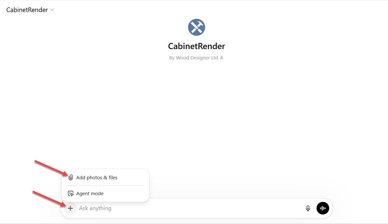

Once you have your screenshot, upload it via the ‘Add photos & files’ option.
An image showing how to upload into the CabinetRender tool
As usual, click to enlarge
Alternatively, copy and paste directly into CabinetRender or StairRender.

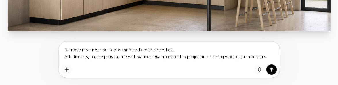

Once uploaded, click on the ‘Send prompt’ up arrow button to create a realistic render from your image without changing any details in the uploaded screenshot.
Upload parameters in the CabinetRender tool
How to send an image for rendering
Although you can include written instructions along with a screenshot as part of the initial prompt, we recommend starting with an image-only prompt. Consider additional prompts after you’ve reviewed the first render.

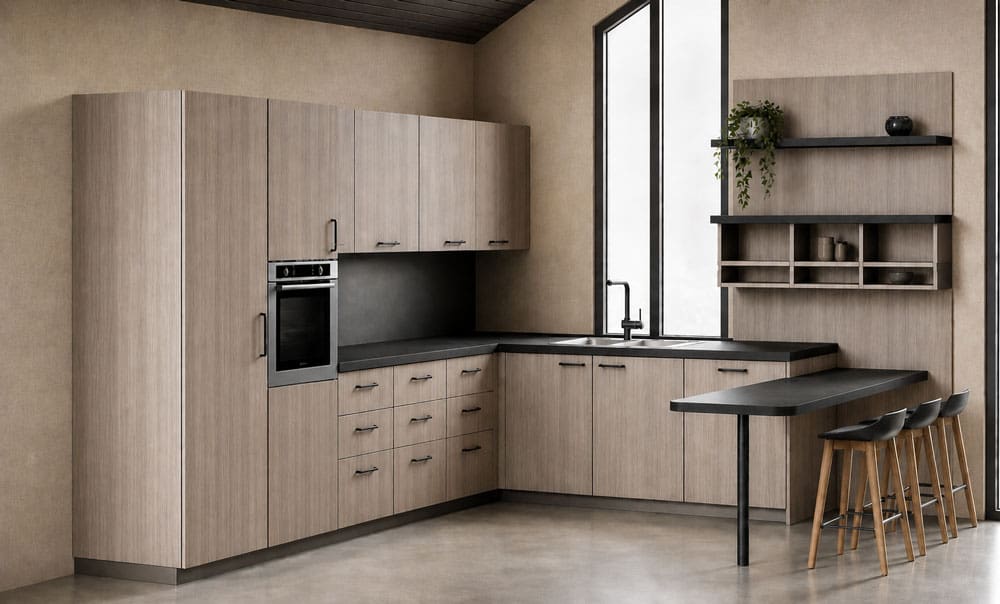

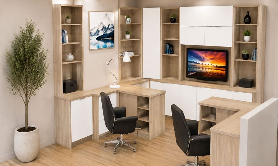

Below are some example renders, created from the project screenshots we showed above:

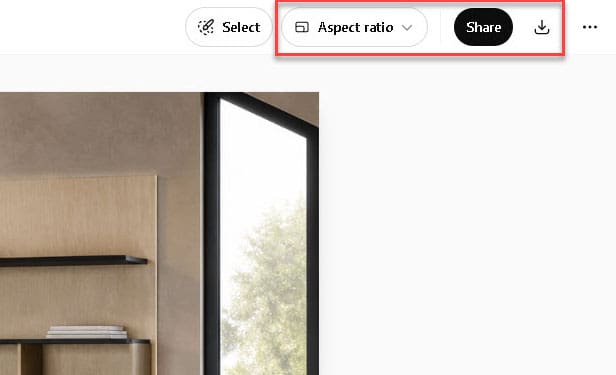

Once your render is complete, click on the image to select it and to confirm it has been processed as required.
Once you are happy with your image, you have new options available:
Options to save a render
  • Aspect ratio: generate a new image in a chosen aspect ratio
  • Share: to the available 3rd party platforms
  • Download: save the render to your personal device

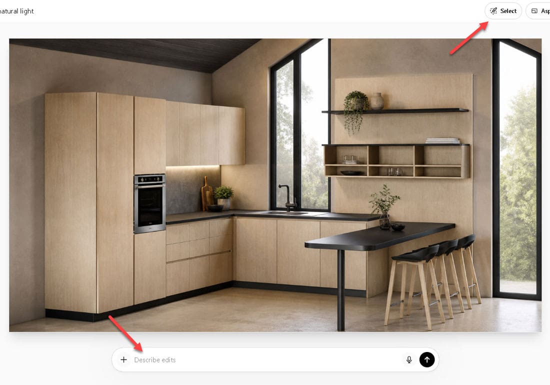

Modifying your renders
Once you have uploaded your generated render, you can then further prompt the AI to make adjustments.
First select your image; the following options are now available:
  • Select: allows you to highlight specific areas of your project so the AI knows what elements you want adjusted
  • Describe edits: this is where you add a prompt detailing your desired changes
Tools for render modification
When prompting the AI, be very clear and specific about what you want; describe:
  • Lighting conditions: warm lighting, shadows, natural light
  • Materials and finishes: changes in grain directions, colors and surfaces
  • The environment: modern kitchen, showroom project, interior setting
Additionally, the AI can be used to request changes such as:
  • Adding handles
  • Replacing or changing textures and materials
  • Adding background scenes, for example through the windows
  • Adding extra decorative effects like items on a shelf or table
Clear and well structured prompts result in more predictable high quality outputs. If needed, you can refine a prompt over multiple requests. All images and supporting documentation for your adjustments can be uploaded in the same way as your screenshots, or simply describe what you want.
Example prompts for modifying a render
Once changes are prompted, your new image will be rendered.
Modified kitchen render

When changing textures, we recommend providing a specific image file so the tool knows exactly what you require. For example, below we have modified a home library with an Egger material.
Egger material
We changed the handles too.

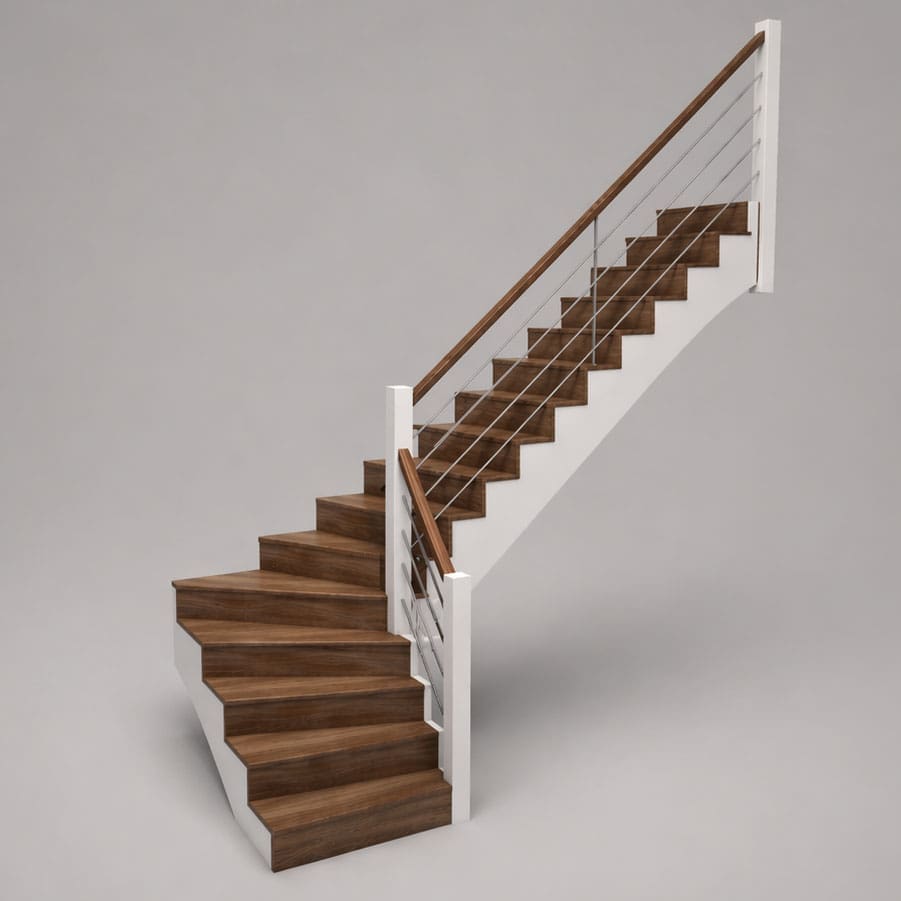

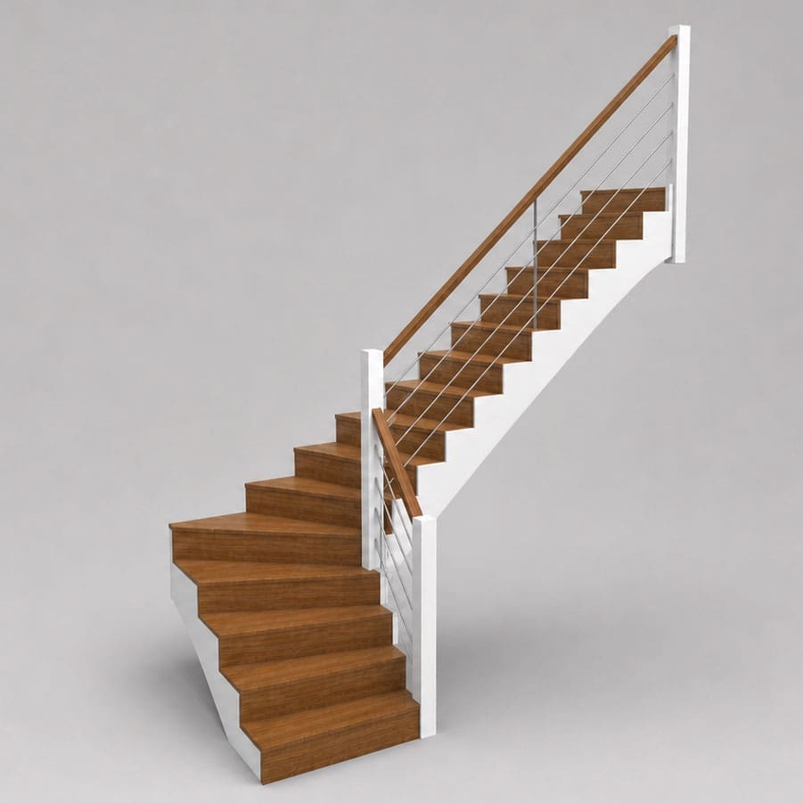

Here is a stair rendered with two alternative materials.
When using StairRender, images are generated with a grey background by default, although alternative backgrounds can be requested.
If you’d like your images to include a room backdrop, you can export your model from StairDesigner in 3DS or 3D DXF format, then create the environment in third-party software before uploading it to StairRender.
An open quarter-turn staircase in a room
