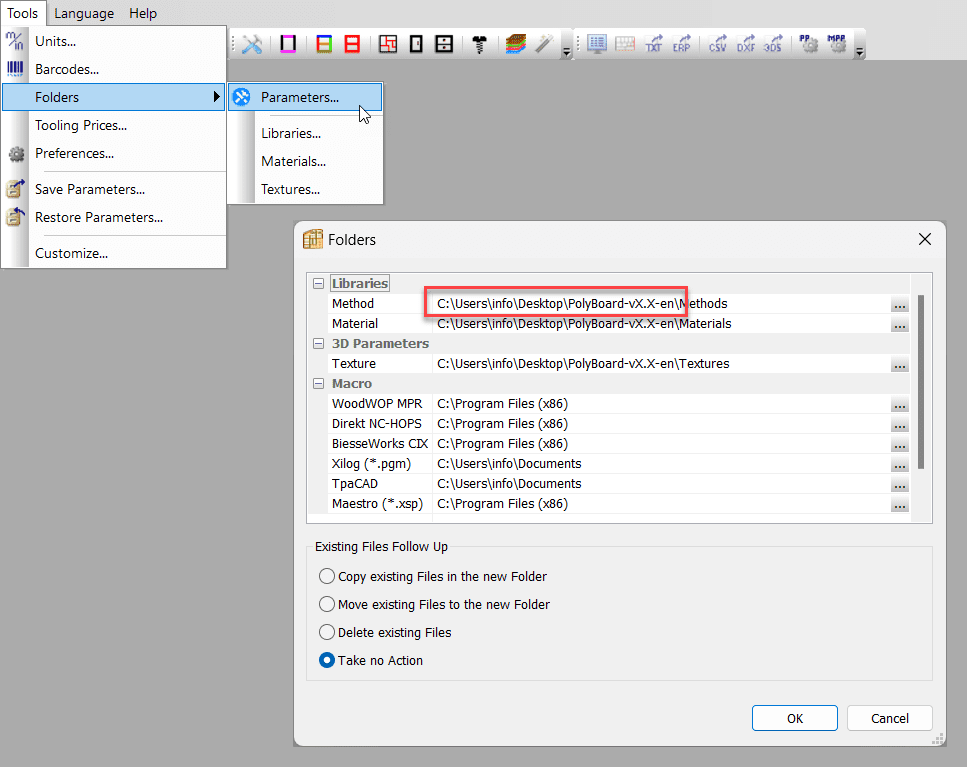

Not sure where your libraries are located? Go to Tools menu > Folders > Parameters…
The path to your libraries is shown there:
polyboard libraries location
Copy your main libraries folder to a USB key or other remote storage location.

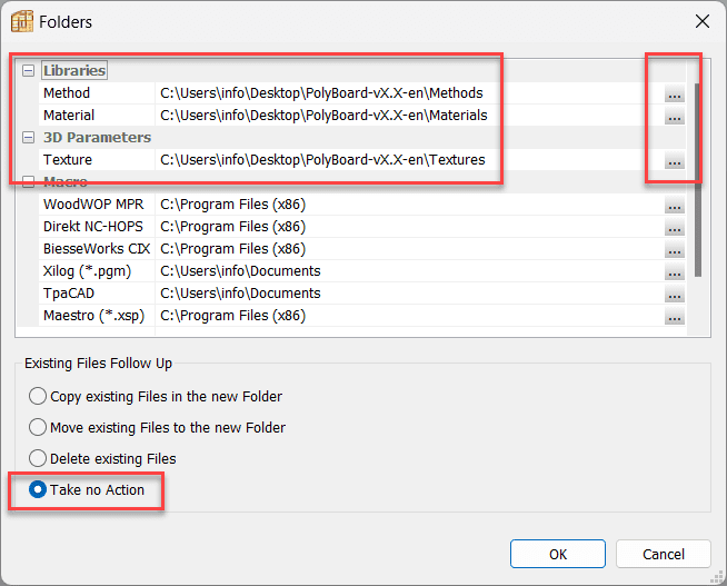

2. Restore your Libraries folders
Copy your libraries folder to the desktop of your new computer (or to any other preferred location) and link your software to it as follows.
In your software go to Tools menu > Folders > Parameters…
Select the 3 dot … icon and navigate to the appropriate sub folder in the main libraries folder. Do this for the following sub folders:
  • Method
  • Material
  • Texture
Important: always select Take no action.
polyboard link to libraries

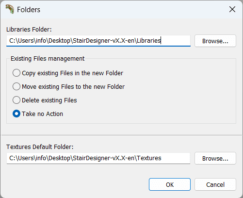

When linking the libraries folders to StairDesigner, there are only two as shown below:
stairdesigner link to libraries
