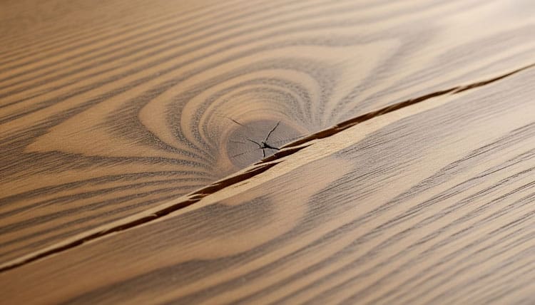

Everyone who has completed a woodworking project and had to fill in a scratch, crack or defect, knows that filler behaves differently to stain and so stands out and detracts from the finished product.
Natural wood is porous and grows in a cell structure with grains and an uneven, irregular finish whereas filler is a uniform and relatively impermeable so when you apply stain, the two surfaces react differently and leave an obvious mark.
Wood crack for repair
If you’ve arrived here because you’ve already applied stain to your wood filler and you’ve ended up with dark blotches or lighter halos on your finished carpentry project, don’t worry, there are a few measures you can use to seamlessly blend the problem away.

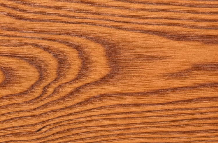

To blend the contrasting surfaces you can draw in a faux grain directly on to the repaired area with localised pigments.
  • Firstly seal the area with shellac or a clear sealant to preserve the original stain and allow you to paint details on top without the colors bleeding into the raw timber
  • Using a fine-tip brush with acrylic paints or specialized wood-graining markers, start with the lightest colour and once dry, recreate the grain with a darker hue
  • When you have recreated the surrounding wood on the filler section and the paint is dry, seal it with another coat of clear polyurethane or lacquer to preserve your handiwork

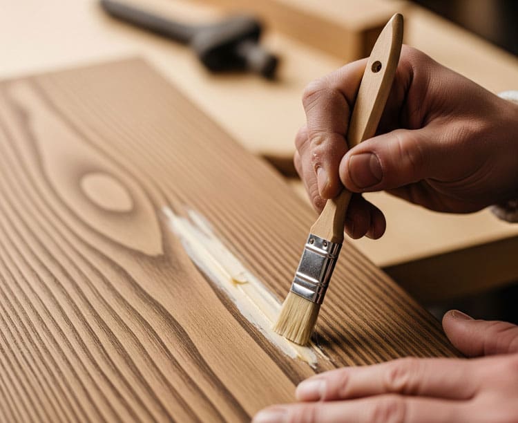

Using a gel stain glaze as an alternative can be a good remedy because a traditional penetrating stain soaks into the wood but a gel stain sits on the surface like a thin varnish. So it has less of an effect on the filler, allowing it to blend in. With a dry cloth or a small foam brush, apply a small amount of a matching or slightly darker gel stain on the filled section.
Repaired wood
Brush the gel stain lightly across the filled area, feathering the edges into the surrounding wood. Since it acts like a glaze, the gel will coat the non-porous filler and mask the color discrepancy.

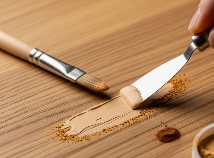

Blendal sticks and powders are professional-grade, pigment-rich touch-up products designed specifically to add, alter, or replace missing color on wood repairs (like wood filler or raw edges) without stripping the finish.
wood filler repair
Use graining markers for long, fine lines or nail holes by drawing sharp lines. Alternatively, try wax crayons on deeper gouges and micro-cracks by rubbing into crevices and over the finish. Lastly, consider powders for broad color shifts and transitions by dabbing on with a small brush and alcohol.
