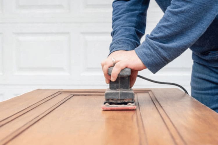

How to prepare cabinets for painting
Every successful paint job has been put through a quality preparation phase. Spending time in preparation will save resources and problems later in the life of the paint job.
Before painting:
  • Remove all hardware, doors, and drawers from cabinets
  • Completely clean every surface for the removal of wax, grease, dust, and cooking residue; these will stop paint from properly adhering to the surface
  • Fill in any dents, scratches, and holes with a wood filler and sand it smooth after it has dried
  • Use a fine sandpaper and sand every wooden surface
  • Clean all surfaces so they are free from dust; a vacuum followed by a damp micro fibre cloth will do the job
If any of these steps are not completed comprehensively, the chance of paint peeling or chipping dramatically increases.
Preparing a wooden door for painting
Sanding a cabinet door

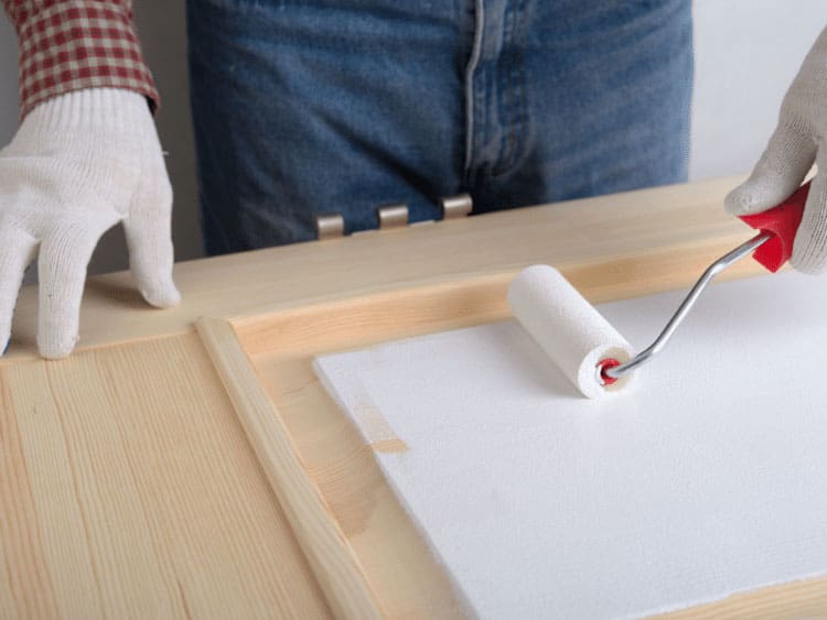

An appropriate primer
Using a primer on cabinets
Also note that using a primer is extremely important. A good primer will improve adhesion, prevent stains, and assist in creating an even and smooth finish. Primers are especially important when working with darker woods or previously stained timbers.

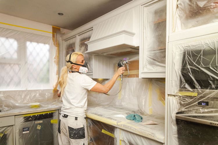

A painter using a spray gun on wooden cabinets
Spraying wooden cabinets

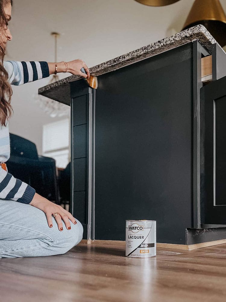

Benefits of using a water based polyurethane
Most modern paints for cabinetry are highly durable, so an additional clear coat is not necessary. However, if cabinets are being used heavily on a daily basis, a water based polyurethane will add an extra layer of protection against damage.
When comparing a water based poly with a traditional oil based polyurethane, there are several advantages of the water based product:
  • Exceptional resistance to wear from everyday usage
  • Quicker drying times
  • Lower odor and VOC emissions
  • Less yellowing allowing the paints natural color to be retained
  • Easier and safer water clean up
A water based polyurethane being applied to painted cabinets
Applying water based polyurethane

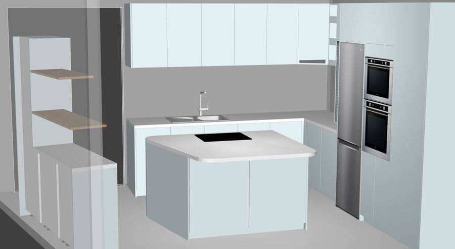

If you are planning to design and build new cabinets, PolyBoard is a tool that can help you design professional cabinetry. PolyBoard is a software that will generate all dimensions, cutting lists, manufacturing drawings, and CNC files.
A light blue paint on kitchen cabinets in PolyBoard
A painted kitchen project designed with PolyBoard
Download and test PolyBoard to explore its full range of cabinet design features. If you are interested in using this software in your workshop, please contact our team to arrange a demonstration session and discuss how it could fit into your workflow.
