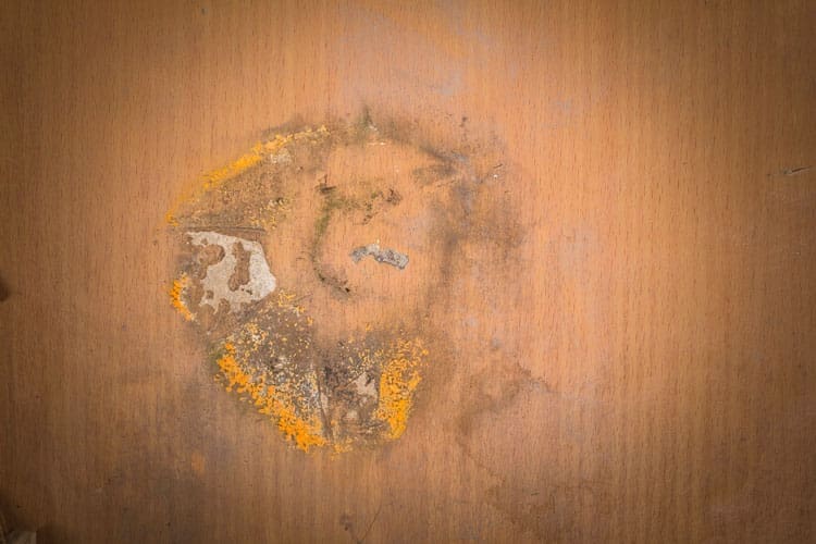

Mould doesn’t just magically appear from nowhere, it forms from a microscopic opportunist that is present in abundance in the air that we, and our furniture, live in. In normal conditions, the spores that cause mould are inert and float around harmlessly minding their own business.
However if you make the environment your furniture resides in too comfortable for the spores, they will settle in and turn into a fully grown fungal infestation.

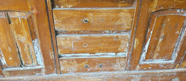

Sanding
If all else fails, you’ll need to sand the affected area down to bare wood.
  • Use a fine-grit sandpaper
  • Wear your mask (sanding mould is high-risk when inhaled)
  • Once the mold is gone, you may need to treat the area to blend it in with the rest of the piece

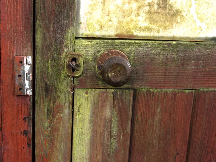

Green mould
If you don’t have the option of changing the environment that the furniture is kept in, various treatments are available.
