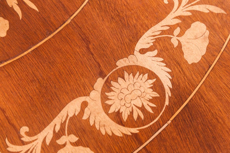

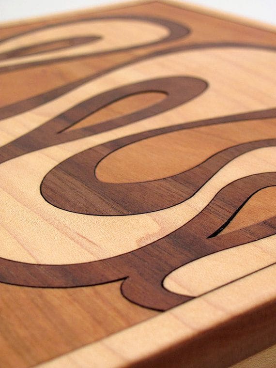

Inlays are the embedding of material pieces into another material’s surface. This is usually used for decorative purposes, enhancing the appearance of a work piece, or for drawing attention to specific detail such as the writing in signage.
Intricate timber inlays using multiple species of timber
Inlays have been used for thousands of years in timber joinery, commonly seen in furniture and musical instruments. Modern day inlays are regularly used for similar projects and signage.
Craftsmen have traditionally created intricate inlays manually, although with evolving technologies, inlays are now more efficient to manufacture and the intricate possibilities are evolving with modern day software and machinery. CNC machinery allows for the automation of the manufacturing process.

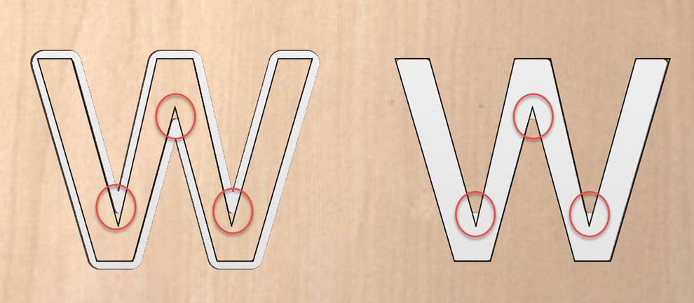

Using standard pocketing and profiling toolpaths on a CNC machine will not allow for inlay features as internal and external cornering needs to link with its corresponding component.
An impractical inlay made with profile and pocket toolings, unable to practically work
Inlays using profile and pocket toolings (not utilising the inlay feature)
VCarve allows for the recognition of inlay toolpaths, and will automatically compensate for the tool radius on corners.
A complete and practical inlay tooling completed with VCarve’s inlay tooling feature
Inlays using VCarve’s inlay tooling feature

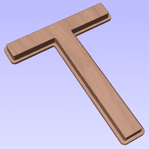

The male inlay can be either straight or stepped. A straight cut is a cut the depth of the components, creating simple inlay inserts.
Inlay toolpath options in VCarve Pro
Stepped inlays have a step toward one side of the component so that the insert can be mounted when fitted into the female component.
Stepped inlay created using VCarve Pro

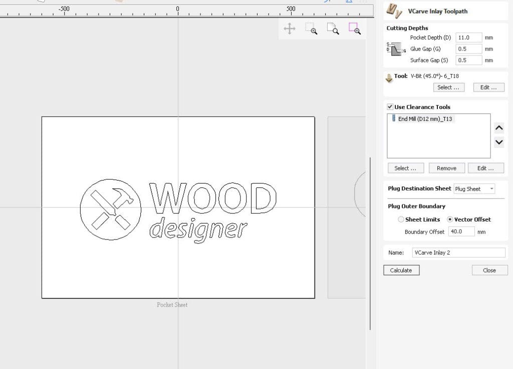

VCarve Pro has customisable parameters for V-carving inlays, including allowances for glue, depths, multiple machine tools, and boundaries. See below the parameters available for setting up a VCarve inlay toolpath.
Toolpath parameters for VCarve tooling

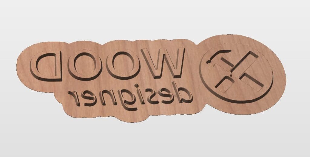

Once the parameters are set up, VCarve Pro will automatically assign toolpaths while recognising the required allowances. The VCarve inlay toolpath feature will mirror and reverse the geometry of the plug against the pocket, and place this on the specified sheet materials.
A pocket and plug VCarve toolpath
VCarve Pro speeds up the process of creating complex inlays by automating actions and creating smooth and comprehensive machinable inlays.
Inlay animation from a simulation in VCarve pro
Inlay plug (bottom side), reversed and ready to flip and install into a pocket tooling
