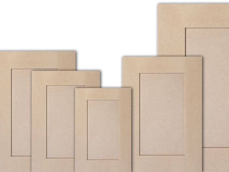

MDF panel with central pocket tooling and polyurethane
A common method of manufacturing shaker doors is using MDF material, such as an 18mm MDF melamine panel, and pocketing an inner rectangle to create the illusion of a central panel surrounded by styles.
This method can be completed with a hand router or a CNC machine, allowing most manufacturers to make this style of door. The door is commonly finished with a polyurethane paint, and processed for project installation.
MDF shaker door
MDF shaker door with central pocket
So if you’re thinking how to build a shaker cabinet door as efficiently as possible, this is a good option only requiring one material. The downfall of this method is the timely finishing required to cover the MDF material.

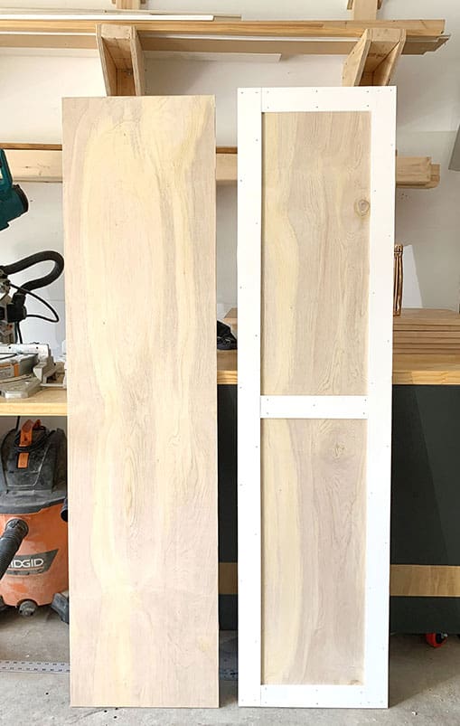

Fix a frame over a larger back panel
This method sees a frame manufactured which acts as styles, all fixed over a larger back panel. This involves a frame glued to an MDF sheet (or similar material), creating the perception of a shaker door. This is a fast manufacturing process that requires minimal equipment, although it won’t create the same aesthetic as other methods.
Adding a frame to a back panel
Adding a frame to a back panel (credit Remodela Casa)
The door can be manufactured with most materials and completed with a range of finishes such as paint, varnish, or vinyl.

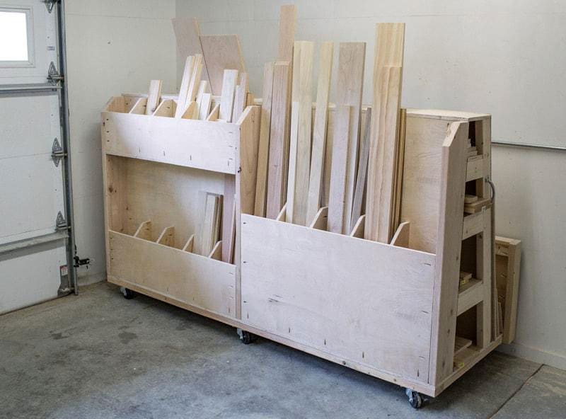

To reduce this problem, store panels appropriately in a dry and safe place and finish the doors before they can be influenced by varying weather conditions.

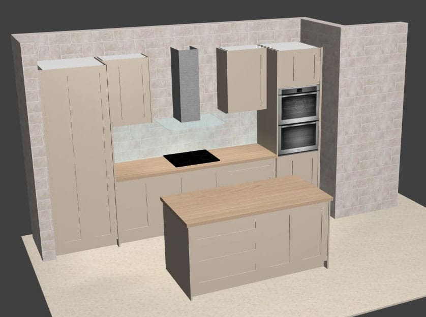

PolyBoard is a software for cabinet design that allows for complete cabinet door customization. PolyBoard fully accommodates shaker door design to manufacturing, whether with a single panel door or splitting a door into multiple components and materials.
The images below highlight PolyBoard kitchen and bedroom projects featuring shaker doors.

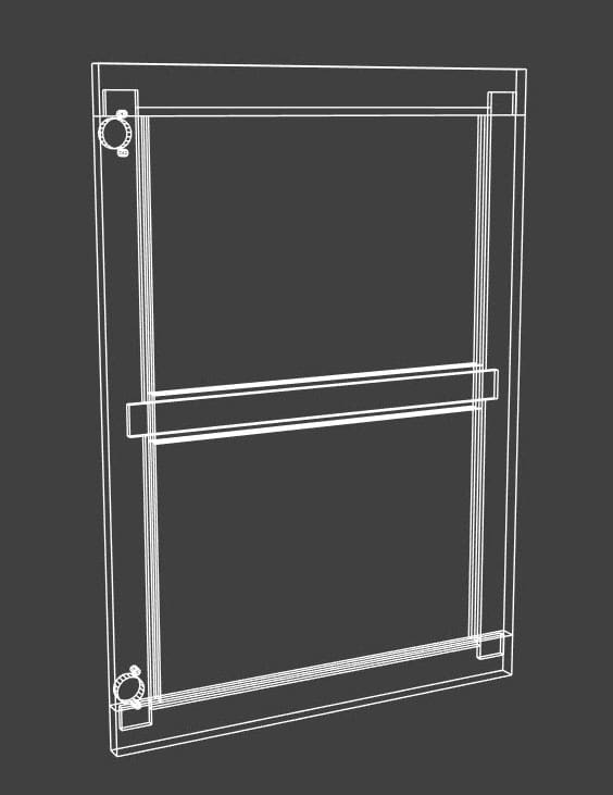

The following close-ups of two doors in wireframe show the structure of a frame and panel assembly vs an inner tooling configuration.
Additionally, all customized cabinet doors in PolyBoard can be saved in a personalized library and re-used as required, with the complete generation of manufacturing documents and any required machining files for your CNC.
