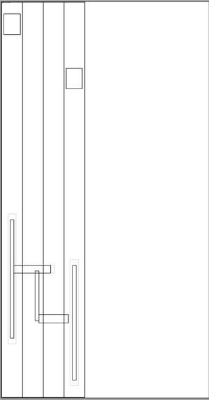

2D plans in workshop PDF document
StairDesigner provides clear precise documentation of each newel on the stair containing all the data like size, face position, top view and drawing of each face with machining details
newel post 2D plan with dimensions
