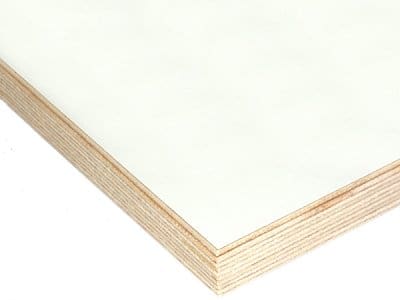

  • Marine plywood

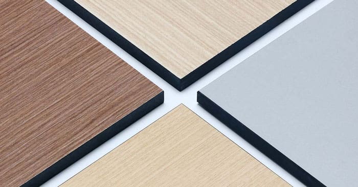

  • Compact laminate

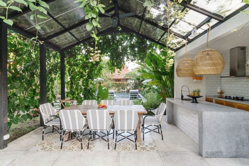

Outdoor kitchen covered by a canopy
All exterior environments should use materials that are resistant to water and higher moisture levels than indoor environments.
Additionally, local construction codes should be understood and adhered to. The construction codes will identify expected practices to limit the risks of fire, building damage, injury and other negative or harmful incidences.

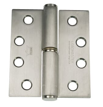

Häfele stainless steel lift-off hinge, ideal for outdoor applications
Commonly, hardware and fittings will need to be made from materials such as the following:

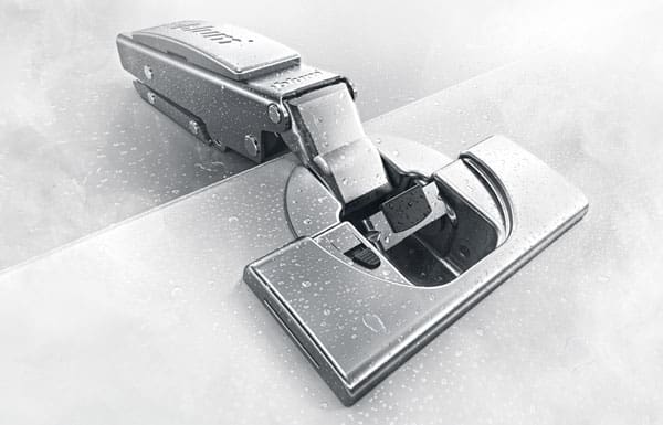

Many manufacturers put additional protective coatings on their products for extended life in outdoor environments. An example of this is the Blum BCOR coating, a galvanic coating for extra protection.
Blum hinge with BCOR coating

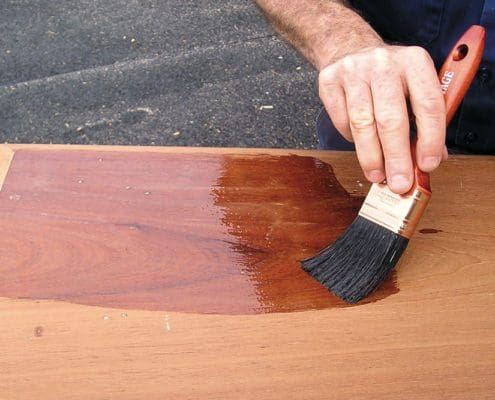

Finishing timber with a brush
Finishing timber with a varnish
Using the correct timber finish for any timber components will seal the material and prevent excessive aging. Finishing can include paint, oils or varnishes.
