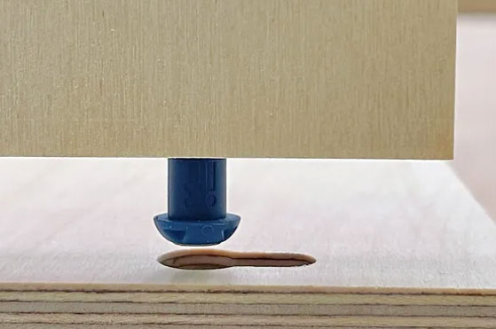

PEANUT 1
Requires only vertical machining so perfect for nesting CNCs, the PEANUT 1 sits flush with the material.

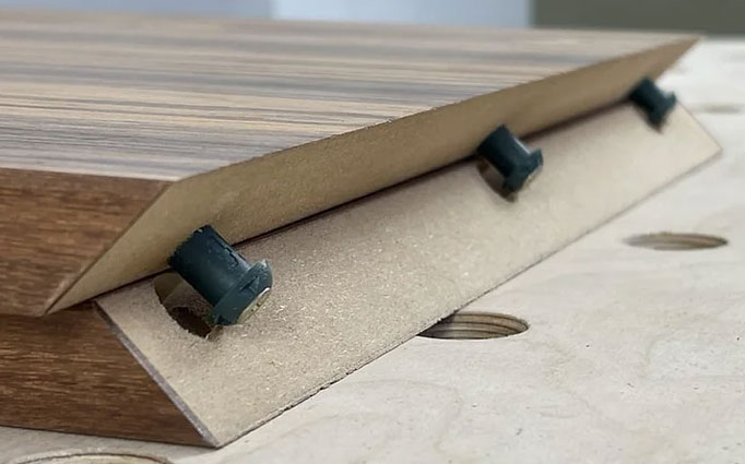

Works with both side drilling machines or a hand held router used in combination with a jig also supplier by Intelligent Fixings. Invisible too!
PEANUT 2 Short
This smaller version is well adapted to mitred joints and end to end connections.

It’s a solid component so unlike the PEANUT 2 it isn’t fixed in place with a screw. Used in conjunction with side drilling machines.
