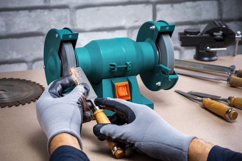

Sharpening Tools Using a Grinder

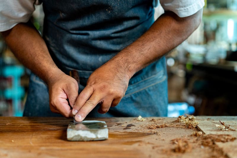

Sharpening Tools Using a Stone
Creating a sharpening habit
As with any good habit, frequent sharpening is much more effective than occasional, unscheduled firefighting.
Develop a routine based on the frequency of your woodworking and the types of wood you typically work with, softer woods will dull edges less quickly than hardwoods due to their higher density and silica content.
  • For frequent woodworkers, setting aside time each week or month for sharpening can prevent tools from becoming excessively dull
  • Before embarking on a new project, take a moment to assess the sharpness of your tools, a quick touch-up can make a world of difference
  • Learn to recognize the signs of a dull tool: increased effort required, burning smells, rough cuts, and excessive tear-out; don’t wait until the tool is completely blunt
The fundamentals of sharpening: a step-by-step approach
While various sharpening methods and tools exist, the underlying principles remain the same: creating a new, crisp bevel at the cutting edge.
  1. Ensure your tools are clean of any dust, rust, or pitch, a wire brush or solvent can be used for this purpose
  2. Grind the primary bevel to the correct angle, bench grinders are often used for this initial shaping but care must be taken to avoid overheating the steel
  3. Honing the edge refines the bevel and creates a razor-sharp edge, this typically involves using progressively finer abrasive stones (water stones, oil stones, or diamond stones) lubricated with water or oil
  4. As you hone, a fine wire edge, or burr, will form on the back of the blade, this needs to be removed for a truly sharp edge; this is often done by lightly stropping the back of the blade on a very fine stone or leather strop
  5. Stropping on a leather strop charged with honing compound further polishes the edge and removes any remaining microscopic burr, resulting in an exceptionally keen edge

  • Bench grinders are excellent for initial bevel shaping and quick material removal but require careful technique to avoid overheating
