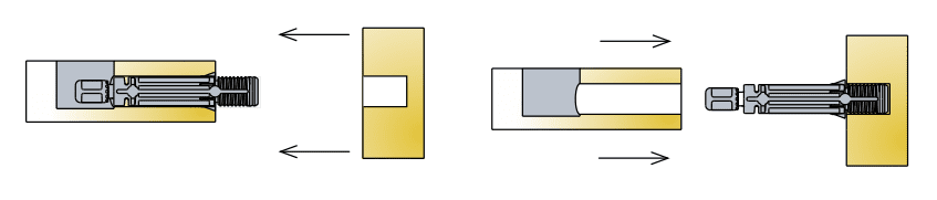

Here’s the Quickfit TL pushed into the edge hole (left) or inserted into the side panel (right):
titus quickfit tl

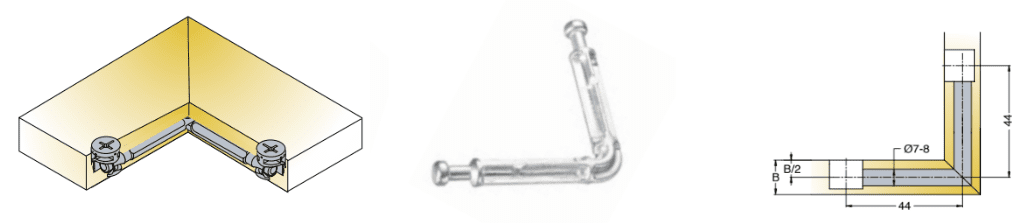

The 90° angled dowel is shown below, perfect for mitred joints:
titus 90° angled dowel

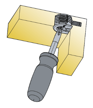

Titus has also developed an Angledriv feature that comes with these connector systems. This is designed to allow insertion of a screwdriver at an angle away from the panel side when locking the cam in place.
angledriv system from titus allowing screwing at an easy angle
