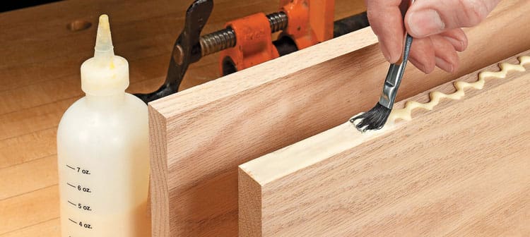

PVA glue (polyvinyl acetate)
PVA glue is the most widely used adhesive in the woodworking industry for both professionals and DIY. It’s great for joinery, the bonding of both soft and hard woods, and for indoor timber applications.
PVA is often recognized as the best wood glue for general purpose work, although is not ideal for high moisture areas or structural outdoor conditions.
A line of wet PVA glue
Using PVA glue to fix a timber joint
Key features include:
  • Easy to clean
  • Dries clear
  • Good working strength
  • Available in both interior and exterior products

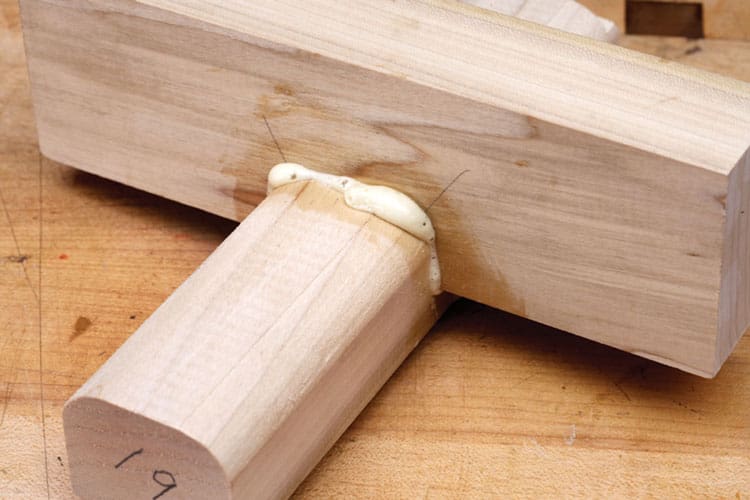

Polyurethane glue
A polyurethane based glue will expand as it cures, which fills small gaps and creates a high strength bond. Polyurethane adhesives are great for outdoor projects, structural timber joints, and the bonding of different materials. This glue needs moisture to activate and tends to be messier than other types of wood glue.
The expansion of polyurethane glue
Expanded polyurethane glue in a wood joint
Key features of polyurethane include:
  • Weather resistant and waterproof
  • Expands while curing
  • Will bond timber to other non-porous materials such as plastics and metals

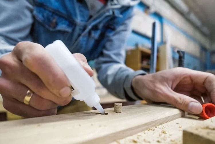

Super glue (cyanoacrylate)
Super glue is an adhesive used for fast bonding applications. It’s great for small repair jobs, filling small holes and cracks in timber, and for precision and finishing touches. Super glue is not suitable for load bearing or large joints due to its brittleness.
Repair work with super glue
Filling a hole with a timber plug and super glue
Key features of super glue include:
  • Extremely fast drying
  • A very high initial strength
  • Available in different viscosity states

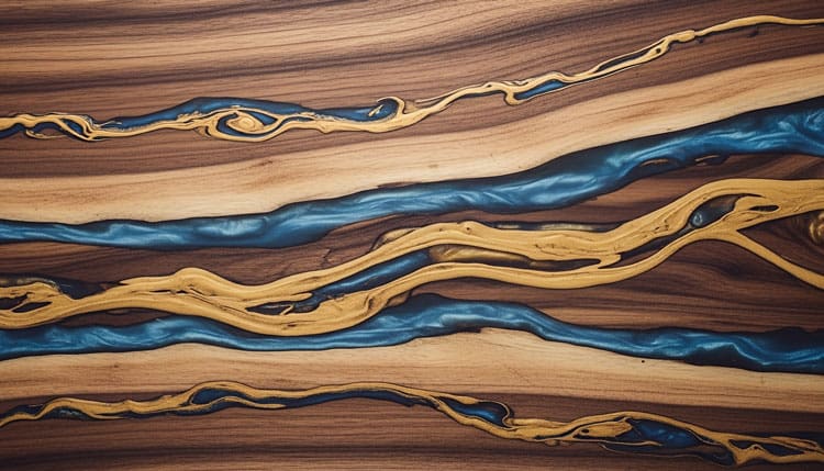

Epoxy resin
An epoxy glue consists of resin and hardener, creating a very strong adhesive. It is best used for structural bonding, damage repairs, and outdoor applications, as well as marine projects. Epoxy resin has a longer curing time, but it’s highly versatile in comparison to other wood glues.
Epoxy resin filler
Filling gaps with a decorative epoxy resin fill
Key features of epoxy resin include:
  • Resistance to chemicals and moisture
  • Capabilities of repair and gap filling
  • Strength for structural bonding

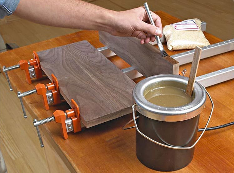

Hide glue
Hide glue is a traditional adhesive that is commonly used in restoration and fine woodworking. It’s regularly used for antique restorations, musical instruments, and traditional joinery projects. Hide glue is reversible through heat when required.
Applying hide glue to a timber joint
Hot pan of hide glue
  • Strong initial tack
  • Available in liquid and granular form
  • Reversible with heat and moisture

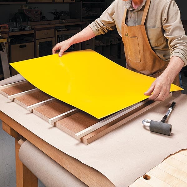

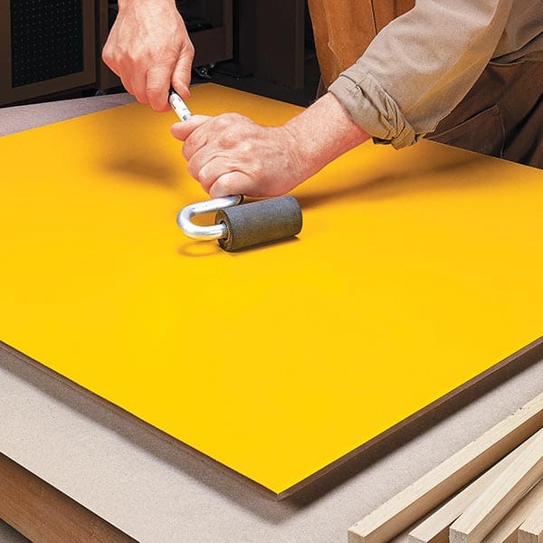

Contact adhesive
A contact adhesive is a glue applied to two surfaces before bonding. It is commonly used for laminating material, veneer sheet contact, and for large surface applications. Contact adhesives need to be applied with precision, as there is no adjustment available post initial contact resulting from immediate adhesion.
Key features of a contact adhesive include:
  • Instantaneous bonding on contact
  • No clamping required
  • A flexible adhesive
