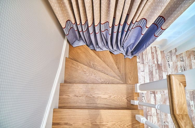

The defining feature of a winder staircase is its winder treads, which are the tapering treads that fan out from the inner corner of the staircase. This contrasts with straight stairs or stairs with a landing, which feature uniform, rectangular treads throughout.
Contemporary winder staircase design
Winder staircases aren’t limited to a single form, their design can be adapted to different layouts, each with its own advantages. A single turn winder staircase is akin, and is often the same as, a quarter turn and a double turn winder is analogous to a half turn.
Quarter turn winders are the most common configuration, featuring a 90-degree turn, this replaces the square landing you’d find on an L-shaped staircase, using three or more tapering treads to make the turn. This design is excellent for tight corners and is often found in older homes or small, modern townhouses.
