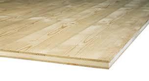

3 ply solid boards
3 ply boards
A fairly new arrival on the wood sheet material scene are 3 ply solid wooden boards.
These boards are a cross between plywood and solid wooden laminated boards.
Available in sheets and as dimensionally stable as plywood, the only disadvantage is the end grain on the edge of the boards.
Although fairly expensive, 3 ply boards can be a great option for furniture projects where one’s looking for a real wood finish and a more robust material than composite, MDF or veneered chip boards.

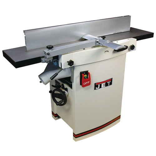

Heavy machinery for planing
If you are building big projects like stairs from raw timber you’ll need some heavy machinery to plane and joint boards.
Building from pre-manufactured materials such as laminated boards, although more expensive, will allow you to build your project with a far lower investment in machines and space.
joint planer
Joint planer
