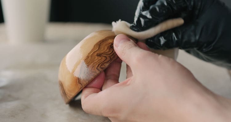

Oil finish on a wooden bowl

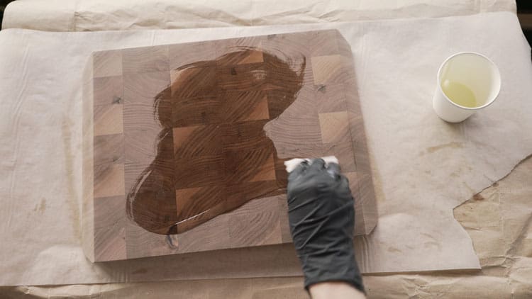

Application: generously apply the oil with a clean cloth or brush and then allow it to soak into the wood for about 10-30 minutes.
