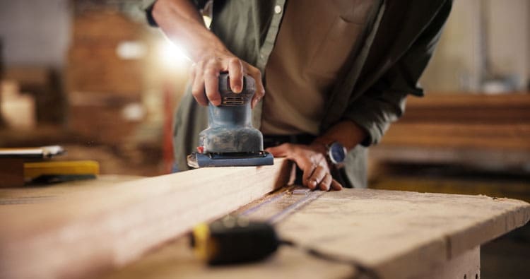

Rough sanding wood for further preparation

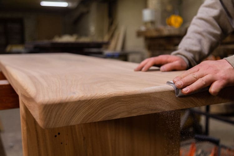

Sanding
For most projects, try to orient the grain patterns so they look continuous, this is called “grain matching” and distinguishes fine furniture from DIY projects.

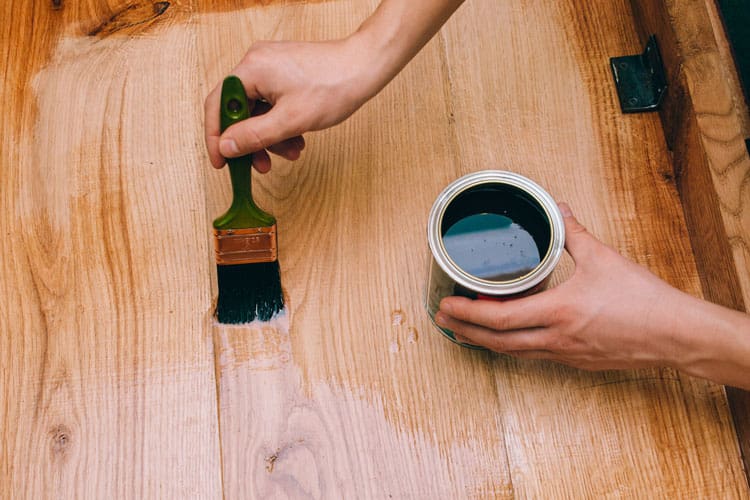

The finish you intend to use plays a large part in how fine a surface you need. A thick coat of paint or varnish is a lot more forgiving than a light penetrating oil. Here are instructions for getting a professional finish, depending on your aspirations you might decide to pull back early.
  • Sand with a course paper – 80 grit, then gradually reduce to 120, 150 and finally 180 or 220 grit
  • If you plan to use a water-based finish, wipe the bare wood with a damp cloth, this expands the wood fibers, making the surface feel fuzzy
  • Dry, then lightly sand with your finest grit again
  • Wiping the wood with denatured alcohol or mineral spirits will reveal any hidden glue spots or sanding scratches that would be highlighted (and ruined) by a stain or oil finish
