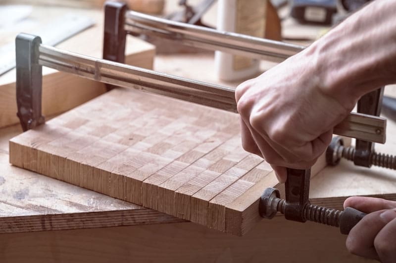

Assemble the board if applicable. Apply glue to the wooden components and attach them. It is recommended that clamps hold them until the glue sets. Assemble the blocks in rows first then combine several rows to produce the desired shape.
