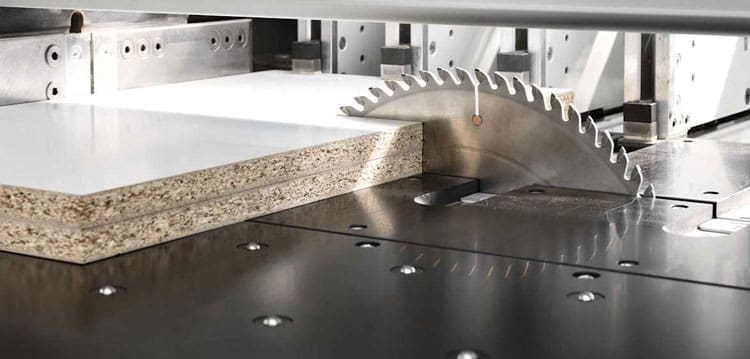

The tooling you use has a major impact upon the quality of finish, accuracy, and efficiency of your projects. When your tooling begins to wear, the effects may start gradually but can quickly create problems for jobs and workflows.
Our tips:
  • Replace or sharpen your blades regularly, before the quality visibly drops
  • Use the correct cutters, blades, and speeds for the specific material and cut type
  • Understand that rough cuts and burn marks are signs of machining resistance and are not just normal defects
A sharp blade cutting timber
Sharp saw blade making a clean cut

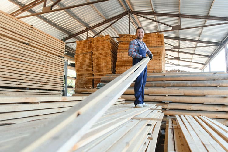

The preparation of your materials is one of the most important yet overlooked stages. If not completed well, it can have a catastrophic effect on a project. Unstable timber will move regardless of how well it is machined or finished.
Our tips:
  • Acclimatise timber in the same conditions as it is intended for use
  • Store materials correctly, and avoid poor or unsuitable moisture exposure; for more information see our article on correct wood storage
  • For manufactured board, don’t allow large periods of resting time post machining

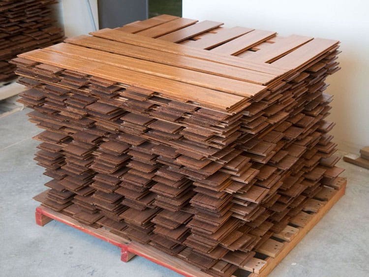

Acclimitising timber flooring
Acclimatising timber in its installation environment

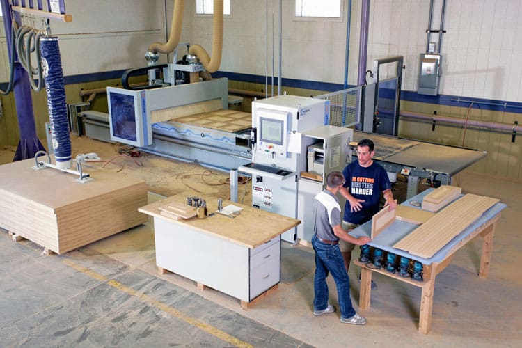

Different workstations in a woodworking shop
A woodworking shop with smooth production pathways

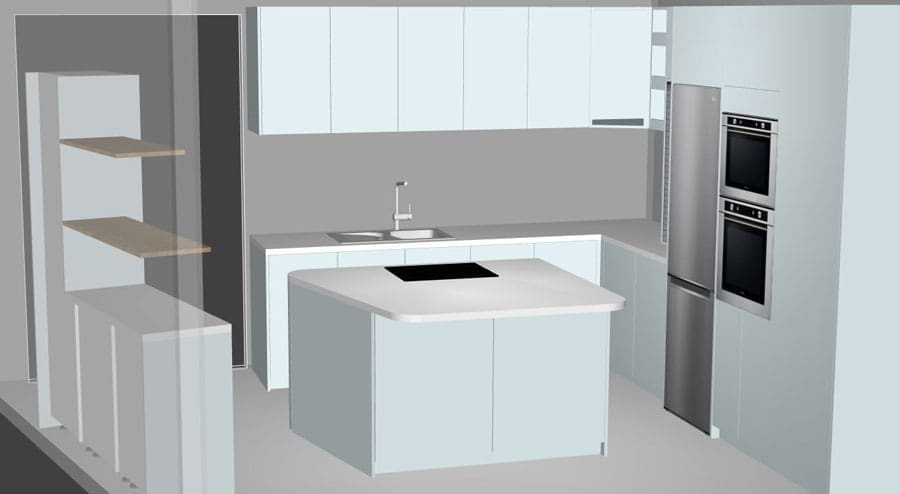

Don’t: waste time with outdated design tools
Designing and processing is a business area that can waste many hours of time. Drawing plans by hand, or using 2D CAD softwares are time consuming and very error prone.
Using quality software processes improves efficiency, decreases costs, and minimises mistakes.
Our tips:

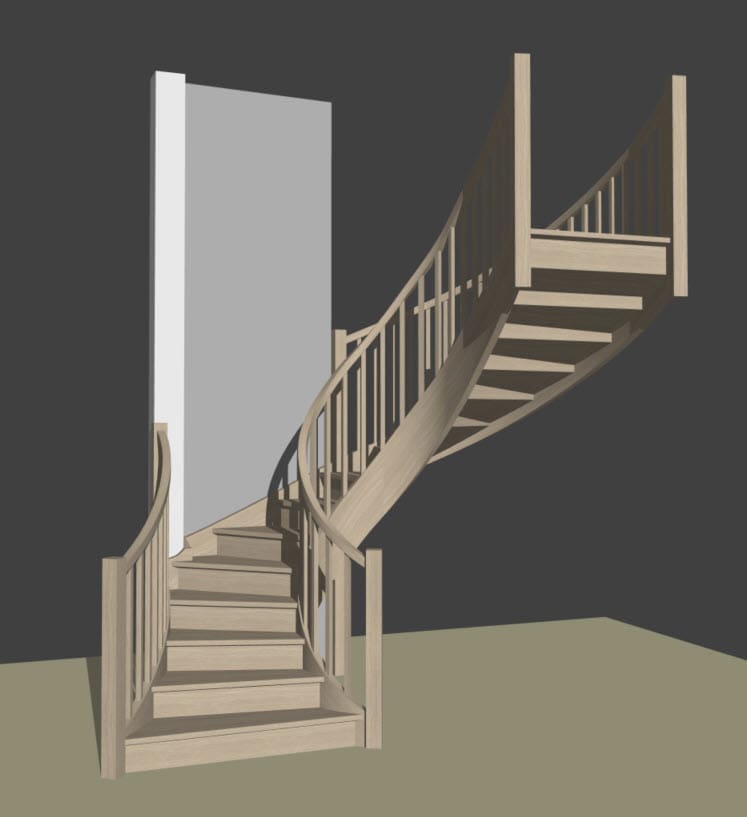

  • Use 3D modelling software for cabinetry or stairs

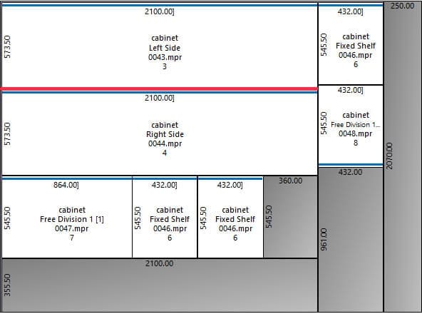

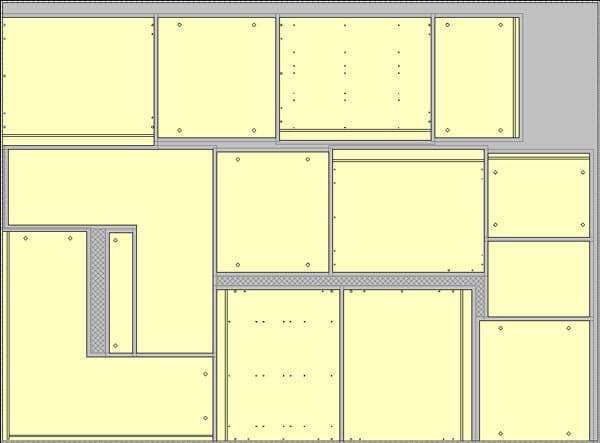

  • Use optimization modules to avoid manually drawing and planning cutting patterns
  • Use software solutions that automate the file integration to CNC machinery
Wood Designer offers a range of software that improves design to manufacturing efficiency with excellent integration with your machinery.
  • OptiNest: high end optimization for nesting CNC machinery
  • OptiCut: cutting pattern optimization solution for panel saws and beam saws

  • PolyBoard and StairDesigner: true 3D design to manufacturing software for cabinets and stairs
