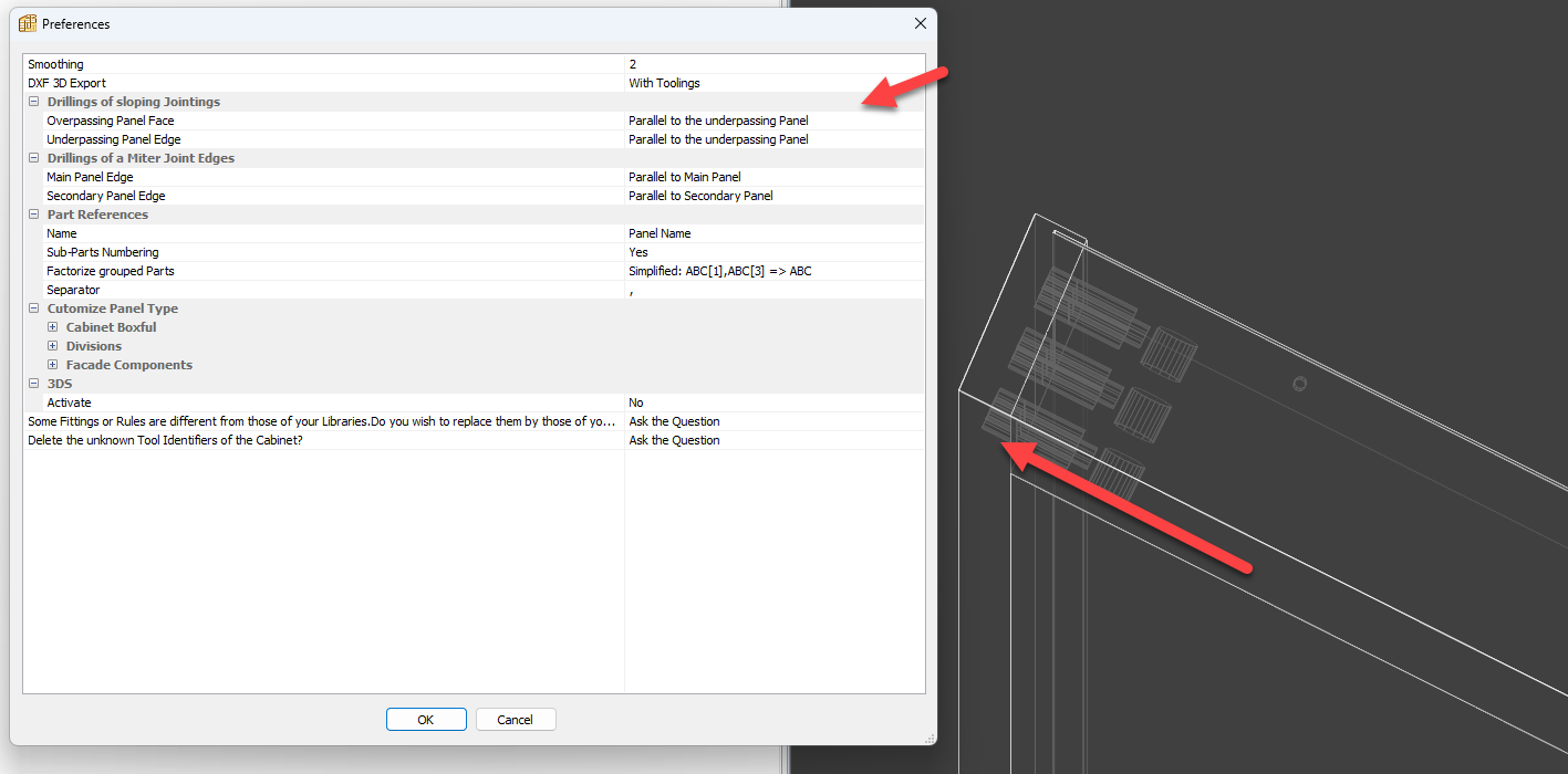

I will pass on the information to the development team,
as soon as the cutting angle exceeds 54° (slope of 36°) the drilling is no longer through, and beyond that the drilling disappears with 18mm panel,

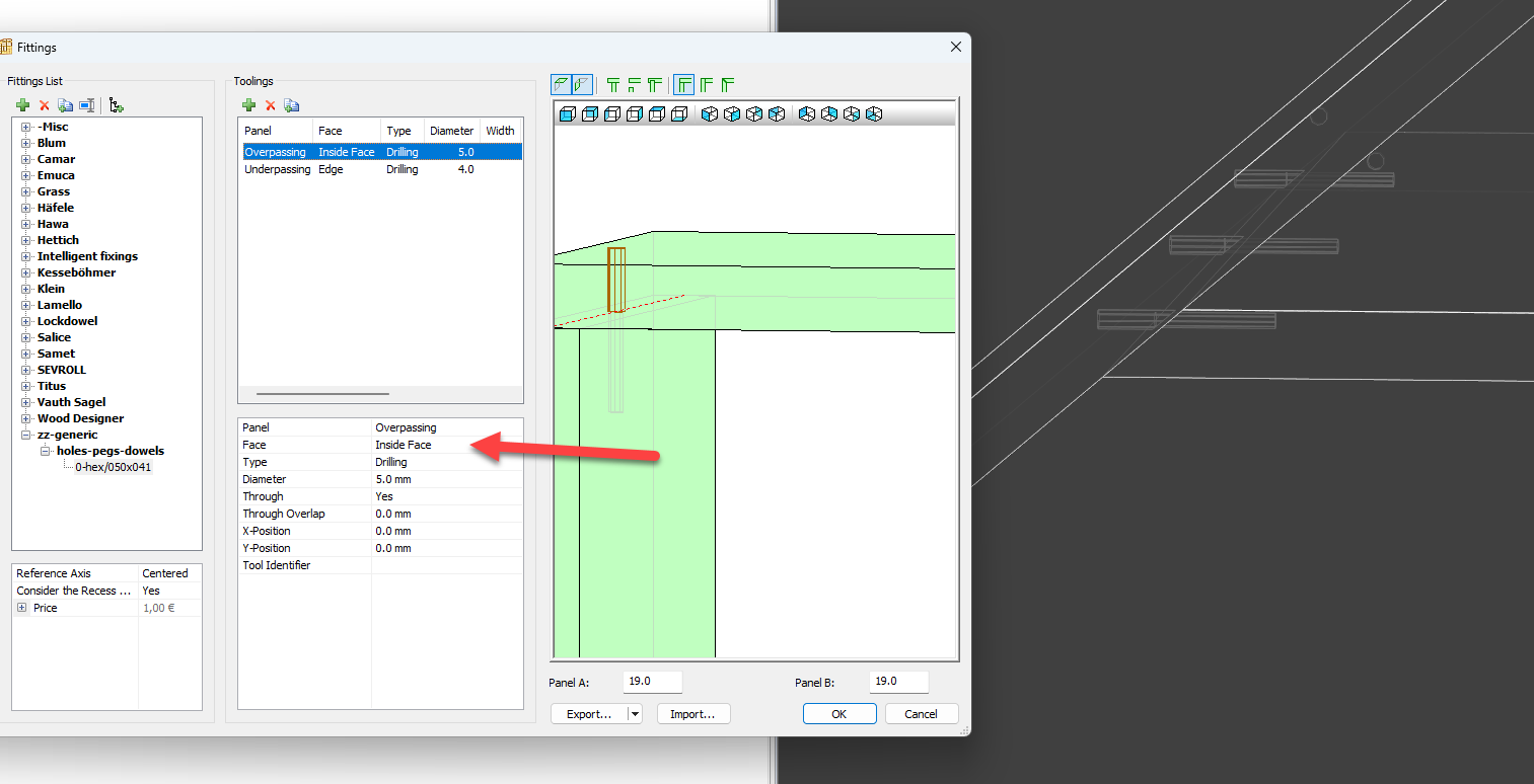

Alex said
Please edit your drilling on overrpassing panel to “inside face” , so that it is correctly aligned
drillings.pngImage Enlarger
but yes i’ll ask why this drilling is not a thought drilling
Yes, I did it,
Interesting – if the angle is wider than 90* – then, if the drill is less then material thickness it is showing the drill, But if the drill is through the overpassing material – it is not visible.
On the other side – if the corner is less than 90*, then if drill is mentioned – through – it is appearing for overpassing panel.
Thanks.
BR,
Girts.

Okay – if I`m playing with fitting dimensions – i can catch the height, But if it`s chosen – Through panell drilling – it`s unfortunately showing not through.

If I make paralell and paralell – the drill for overpassing panel is not at the same height:

Please also check this one:
How to make screws paralell to fixed shelf if top is under angle:
