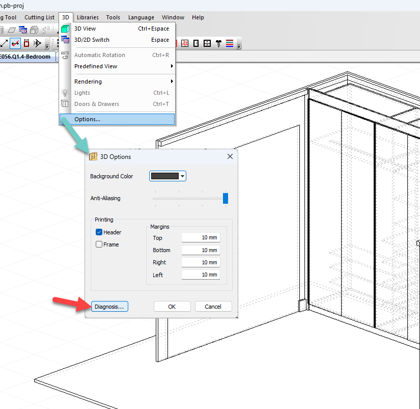

your project doesn’t have any trouble here,
To check the GPU used, you just need to go to the 3D Option
3D-diag-2.pngImage Enlarger

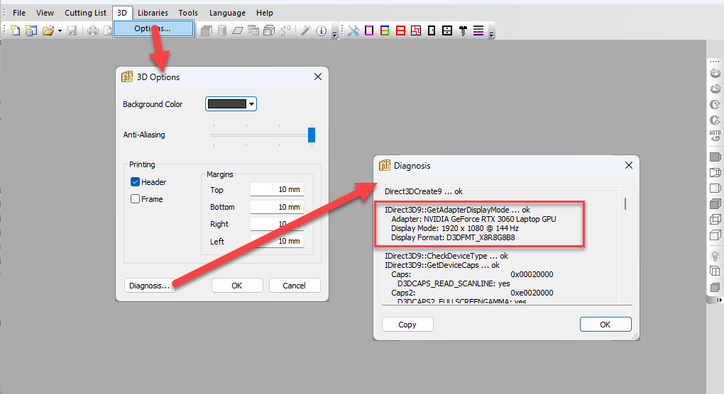

Forum Posts: 2128
January 5, 2024 - 9:02 am
There’s a lot to see,
But I find it strange that the response time is so long, with a better Graphic card than me.
Can you send me a screenshot of the top of the 3D diagnosis?
3D-diag.pngImage Enlarger
If you have integrated GPU on the motherboard, you may need to force NVidia GPU.
(please see the result from my computer and Nvidia Setup; sorry can’t do it in English)
