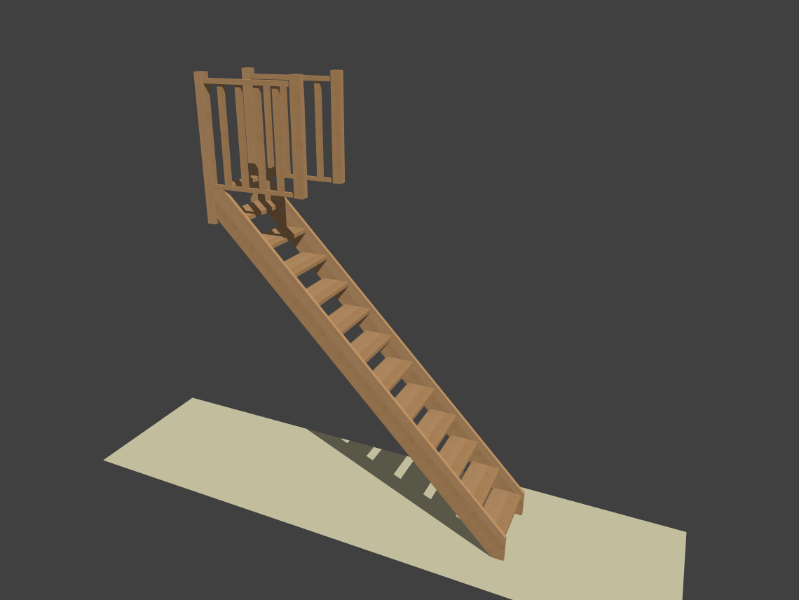

January 26, 2024 - 7:54 am
My colleague Michel sent me this, but not able to help to do it for now
V2.pngImage Enlarger
Hope the stair file help you,

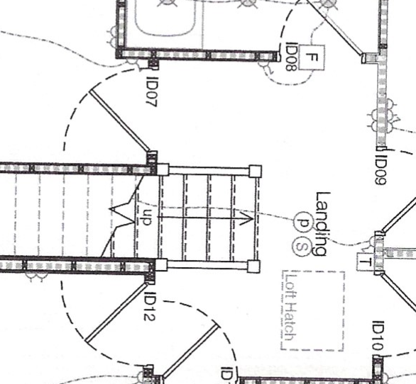

January 25, 2024 - 3:48 pm
Hi Alex
No sorry the balustrade is not on the rake of the staircase there flat off the landing returning to the wall

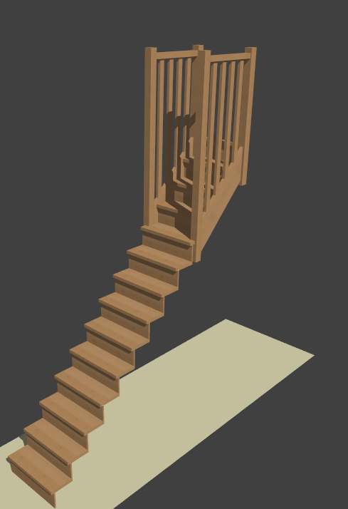

January 25, 2024 - 3:43 pm
may be more something like this?
test-stair.pngImage Enlarger
screenshoot.pngImage Enlarger
