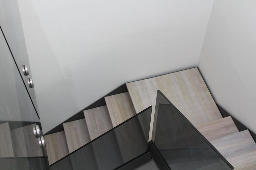

July 15, 2016 - 10:24 am
Hi Aaron,
To design this in StairDesigner just make  the strings the full thickness metal + glass and add glass handrail with thickness of the glass and the full height of the rail.

July 14, 2016 - 1:49 pm
Hi Ness,
Thank you for your reply. I have another question.
The staircase is going to be made of steel and with a glass handrail. As you can see from the picture i would like to opt for this system of hand rail. Ts it possible to design it with this software. if not, can you suggest anything else?
Aaron13062030_753954931408202_7811220364589819387_n.jpgImage Enlarger
13147833_757118507758511_7284223658364428_o.jpgImage Enlarger
