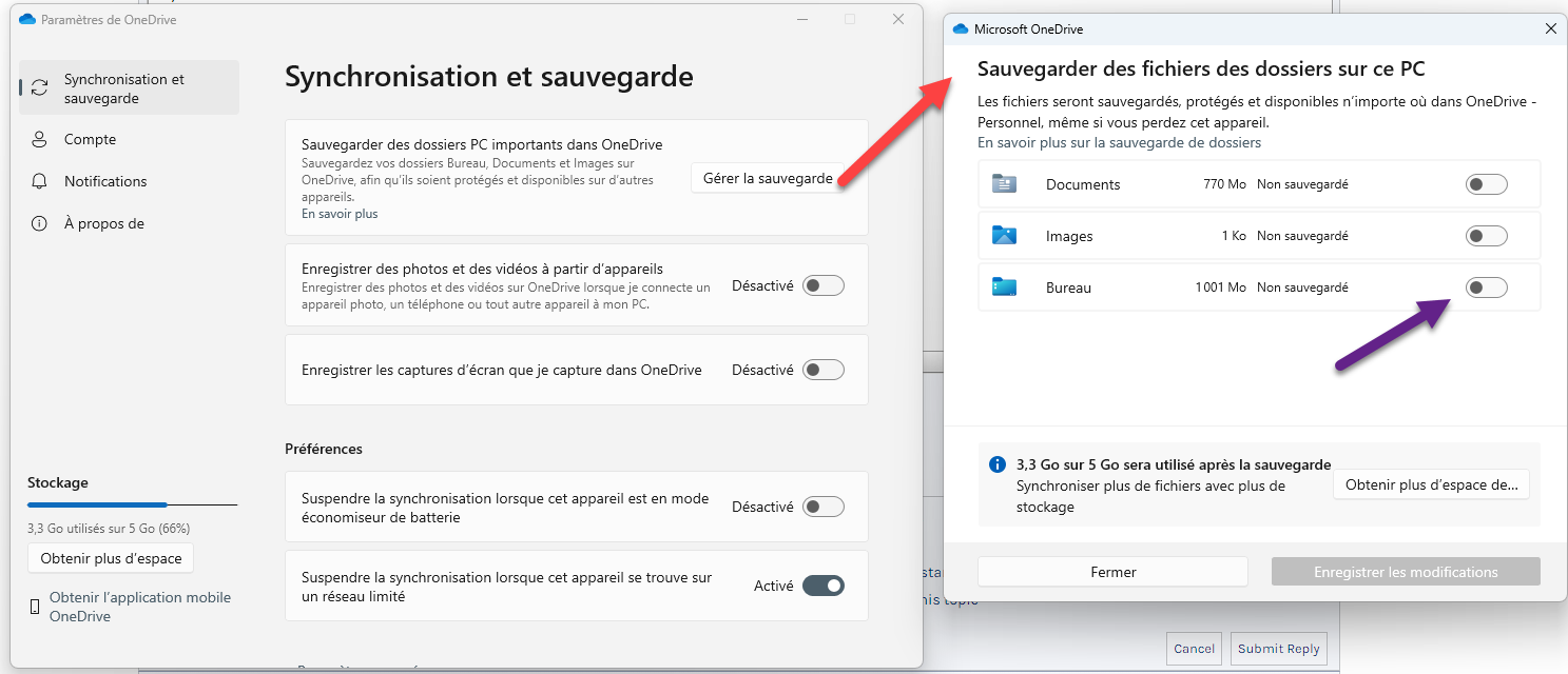

I will send you a mail in few minutes with further information,
Yes, when you connecting to Onedrive without make caution it synchronised your desktop
(Sorry I can’t have EN screenshoot)
OD.pngImage Enlarger
and instead of C:/users/Profilname/desktop
you desktop change to C:/users/Profilname/onedrive/desktop
But it’s to late… the software loses its library folders and has to reassign them manually. Thanks Microsoft….
However, this is a very good solution to stop losing your libraries in the event of a crash.
