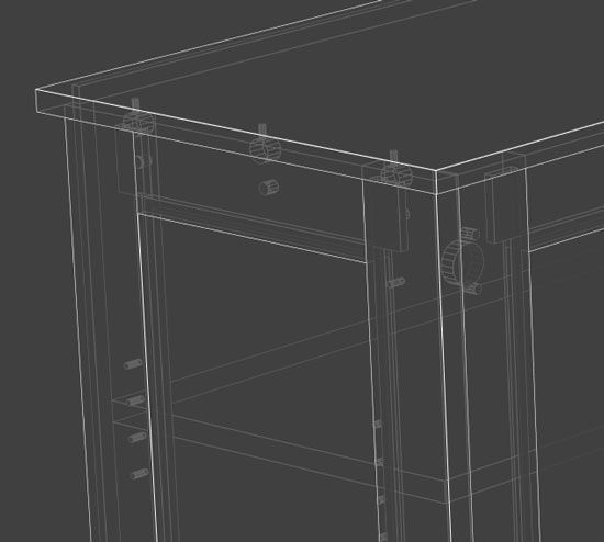

Polyboard wireframe project showing machining - all details are instantly applied and sent to your CNC
