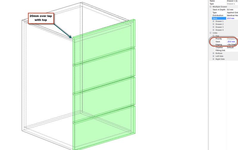

Hi jimbouk,
You can’t make a rounded edge, Polyboard only displays square edges. Of course you can machine edges after in real life but Polyboard wont display it. To add these sort of details you have to export to CAD like SketchUp . You can have a look at this video:
https://wooddesigner.org/membe…..-sketchup/
To make drawers over lap a top just give a negative value to Links to top slack (not the slack between the drawers)  :
drawers-over-lapping-top.jpgImage Enlarger
