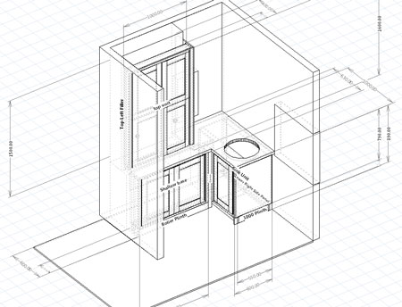

Utility / Boiler Room Case Study
Here’s an example of a project that Mark has recently built.
The project is a utility room where Mark had to design cabinets to fit around and hide a boiler as well as build in a mini kitchen with a small sink and oak worktop.
boiler utility room designed with polyboard
Boiler room before and after
The whole project was set up Polyboard, and here is what Mark says about the time saved:
I found the design using Polyboard easy, as usual, and it allowed me to ‘unbox’ units to allow the customer (more likely the plumber) access to certain parts at any time.
I won’t quote the time savings in detail, but suffice to say Polyboard cut the process in half again.
The workshop manufacture took one craftsman one day to make from the plans, cutlists etc. This included the doors as we have a spindle moulder set up with a 6mm grooving cutter just for shaker style doors. The install took another day with two men.
Could be quicker but as there was a solid oak worktop and sink to install, this time was added.
