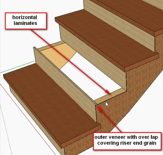

Steps and Risers on a Cut String of Horizontal Laminates
Horizontal laminates make assembling the steps and risers on a cut string much easier. It eliminates the need to cut the step risers in the string, the final shape with the step and riser notches being made when gluing up the laminates.
Another advantage is that the end grain of the risers can be covered up by extending the outer face veneers over the end of the risers. This eliminates the need to mitre the string and riser and enables the riser to be assembled easily against the nice flat surface of the string.
